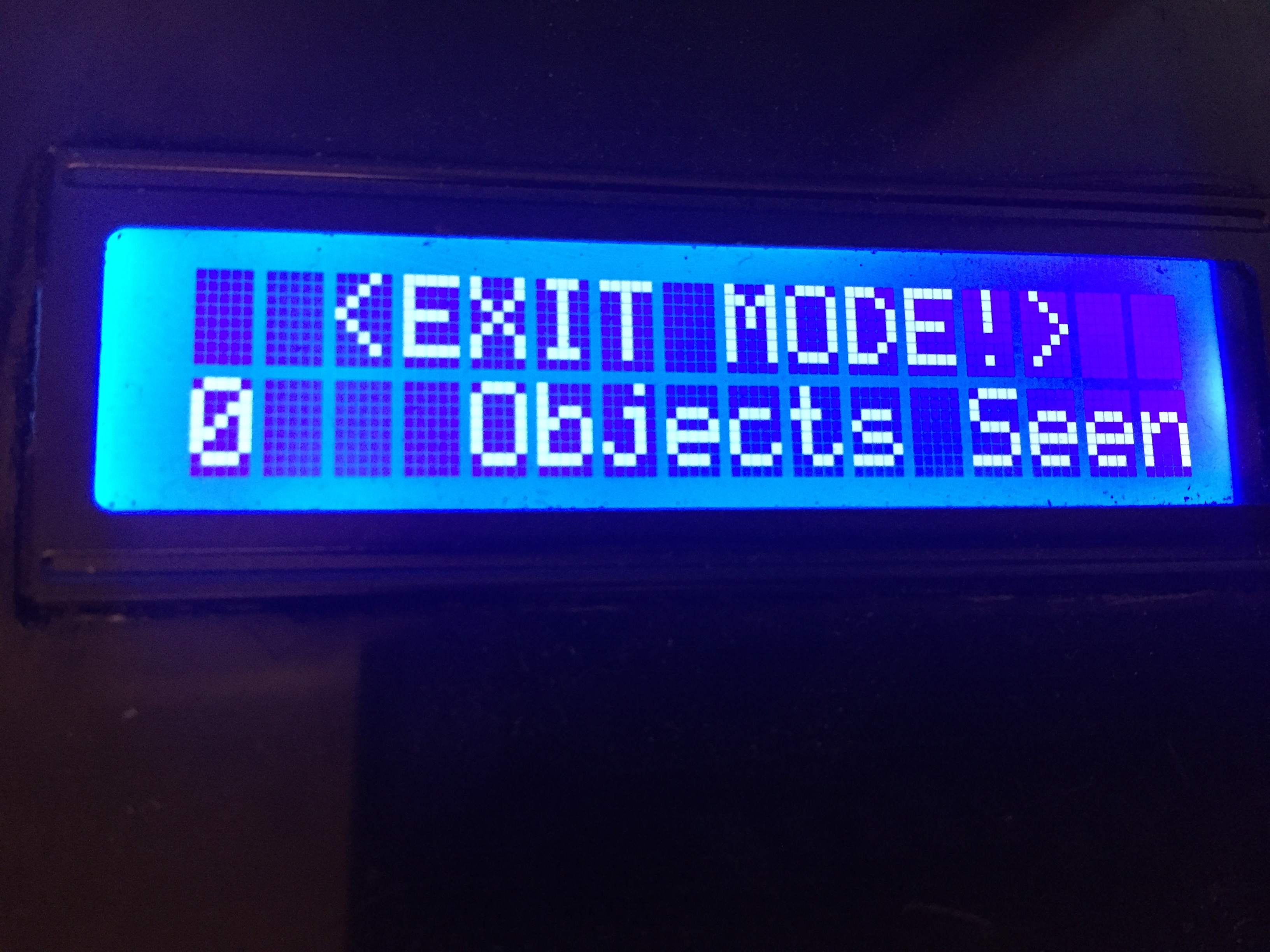

coding issues....
ok, so I'm trying to set up what started out to be a simple code to turn some LED lights on up the drive in sequence.
Then I wanted an exit sequence.
Then I though adding Ultrasonic system to start the lights automatically when someone entered the drive...
After that I decided a PIR would be better suited for the job..
Which I have placed inside a PIR based Cat/animal scare unit.. so looks like original, but will trigger lights
but I cant seem to get the coding quite right.....
it will probably appear messy, as its been changed sooooo many times....
I'm using a 8 way relay block, and just an Uno board, 16x2 LCD display for info inside the house..
it seems to sit and just detect things all the time, or as seems fit enter the exit mode sequence
code is below..

You seem to be using Gate and Exit as if you believe their values will always be updated. But that's not true. They're always just going to keep whatever value the pin had when you read it in setup. If you want to update those values then you need to read the pin again and store the new value there.
can you point me in the right direction, as its really annoying me now... and like this project, but in danger of scraping it lol
do I just need to add something like
" digitalRead(Exit);
digitalRead(Gate);"
in the Loop
You got it.
ok, I have added that, and its still looping in "exit mode".....
Hopefully that is ok now!
Move these two lines to top of void loop()
      Gate = digitalRead(PIRin);            // read and rename input value
      Exit = digitalRead(Switch);           // read and rename input value
You have quite high total delay in your relay on/off sequence, so it might not be very responsive code.
the delay is quite high, as I want the leds (run by the relay) to stay on while people are walking up the drive etc..
And I have moved the code you mentioned, and it is still looping within Exit mode...
(gets the feeling ive upset someone... ) didn't mean too
People are probably upset that you have not posted your revised code
ok, point taken..... I'm just trying to get a few pointers on this platform, and get the code perfect.. with NO intentions of upsetting anyone....

still looping.... and the switch (physical rocker switch) to activate "exit" is good, and the signal is currently LOW.
So I really do not know what is wrong...
Any help, would be great
still looping....
If you mean that it is looping because Exit is HIGH then that is what you need to investigate. Try printing the value of Exit after reading it. If it never goes LOW then no wonder you have a problem. Even better, write a small sketch to test the input that you are reading the exit value from and print that. Does it ever return a value of LOW ? If not, then why not ?
I don't see an issue with the code. I suspect your Switch input is floating. Try a pulldown resistor, or better, use INPUT_PULLUP in your pinmode statement and test for the switch being pressed by seeing if it is LOW.
ok, the code include a serial print line,
    Serial.println(Exit);
and it shows in the serial monitor
1
Exit
1
Exit
I will rewire this to include a small pull down resistor from input pit (Exit) to ground, in order to pull it right down beween switches...
Not sure how to include the option of "INPUT_PULLUP" in my code....
