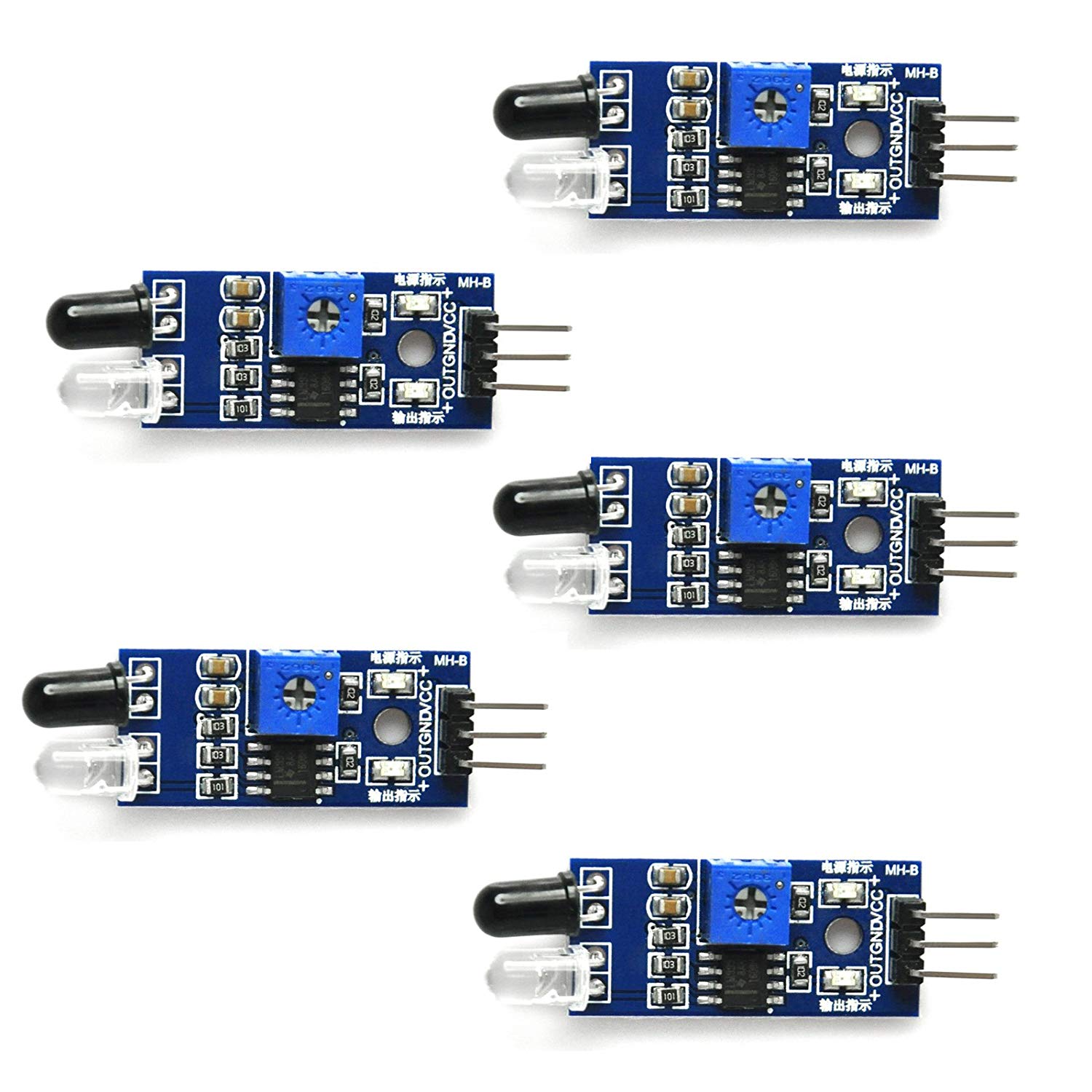

I will order the IR sensors and then do that. I linked the IR sensors down below I think these were the correct sensors
Those sensors don't appear suitable to detect coins passing by.
Get a break beam sensor instead: the two sides pointing at one another. Can also easily be built yourself by just using an IR LED and IR photodiode. Let the coins roll between them for excellent signals.
Those sensors looks like needing a reflector, a mirror, to function. But I agree with You, wvmarle. Unless the coins are thicker then the gap between the IR diode and the photo sensor, letting the coin roll between them looks pretty good.
