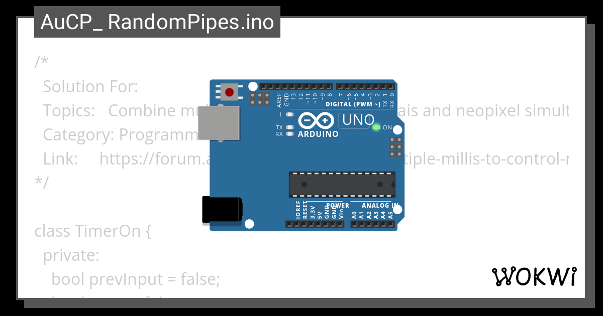

We finally saw how your RunGame() functions. It does not block, rather every time it is called, it scans all N number of timers to see which, if any, have expired, and drops a hammer if it has. It then reschedules that hammer index.
Sry, that was so strange a solution to the OP's problem that I c0uld not read it as anything but a failed attemtp to capture the processor in RunGame() for the duration of one. Game.
I credit a member of the Umbrella Academy for figuring that out - we hooked up some instruments and found RunGame() being called many times a second, performing the entire for loop every time, usually doing nothing N times.
Your code does not block. Neither does it do anything like what the OP required:
  • Drop N hammers in a random order with a random time between them
Rather you are dropping hammer X every so often, and all the others every so often. As a result, a given hammer might be dropped again before all the others have been dropped. As a result, there may be a very short elapsed time during which several hammers are dropped.
Different game entirely. Different kind of fun.
Which is why the real RunGame() needs but one timer. How long to wait before dropping the next hammer. And why it has a mechanism for randomizing N hammers and doling them all out until it finishes. Which is another thing your sketch does not ever do. Finich.
This
                           4116 dropping 7 delay 3246 to next
4884 dropping 4 delay 2520 to next
5488 dropping 2 delay 1449 to next
6031 dropping 1 delay 4802 to next
6325 dropping 6 delay 1832 to next
6438 dropping 0 delay 4869 to next
6604 dropping 5 delay 2173 to next
6938 dropping 2 delay 5739 to next
                           7362 dropping 7 delay 4089 to next
shows hammer 7 being dropped, and scheduling its next drop, so at 4116 milliseconds into the run it drops, then again at 4116 + 3246 = 7362 into the run. No sign of hammer at indices 3 or 8 in between. But plenty of hammers dropping.
See it multitasking here in the wokwi simulator.

The TimerOn object seems like a long way to go for implementing a basic if-now-millis() paradigm, but hey! objects are fun, and yours works.
I do think, however, that anyone using it should know how it works, and that anyone who knows how it works probably wouldn't use it.
Thnks again for posting a complete sketch that compiles and functions. Sorry again for not seeing the cleverness which is your version, never mind it solves a different problem.

I do like your simulator on wokwi. I wasn't aware that it is possible to build with other components. I think your last code is doing something else than I would like it to do, but I'm planning to also build a simulation of the game in there for testing.
I am a newbie to Arduino and may need time to learn a new device like Neopixel Ring :sweat_smile:.
Now, I understand how this game works. I have revised the code by,
  1. Randomize all pipes when starting the game at the same time.
  2. NeoPixel blinking when pipe drops.
    Please see the revised code in the Wokwi simulator.
  Solution For:
  Topics:   Combine multiple millis() to control relais and neopixel simultanious
  Category: Programming Questions
  Link:     https://forum.arduino.cc/t/combine-multiple-millis-to-control-relais-and-neopixel-simultanious/1099091
  Sketch:   AuCP_RandomPipes.ino (https://wokwi.com/projects/358817800677315585)
  Created:  11-Mar-2023 (GMT+7)

And thank you for all of your feedback.
MicroBeaut (μB)
I did. The large difference to the OP's code is your freely running loop(). There really should not be any loops in the loop() function, certainly not ones that take any significant time.
That obvsly full speed loop allowed me to transport a hack I had developed elsewhere. See
Falling Hammers simulation
It was hard-geared for 10 hammers, so I turned that down in the *.ino.
Remains: anything to do with starting and stopping a game, and doing that at a level of difficulty.
Also remains is taking a closer look at your code - TBH I just looked until I could install the display hammers stuff.
L8R
a7
Please see the main topics that have been changed,
  • Added Start/Pause, Stop buttons (using RepeatButton Library)
  • Added the level simulator button (using RepeatButton Library)
  • Modified the TimerOn object and the moveHammers function by adding the `pause' parameter to support the Pause function. When the Pause function is added, the elapsed time will be paused.
  • Added the LimitObject for the level time delay
To increase the level, just put a Level simulator button :sweat_smile:.
Please click this link to run the Arduino emulator, and see the below code,
  Solution For:
  MicroBeaut (μB)
  10-Mar-2023:        changed for changes 10-Mar-2023?!
                      https://wokwi.com/projects/358876197860297729
                By:   @alto777
  12-Mar-2023:        Changed,
                      - Modified TimerOn by adding getTimeDelay() function and renaming "done" to "isDone"
                      - Defined Pipe color status
                      - Added RandomCollector() subroutine for pipes
                      - Added Dropping() subroutine
                      https://wokwi.com/projects/359013222335749121
                By:   @MicroBeaut
  12-Mar-2023:        added hack hammer display machinery 23-Mar-2023
                      https://wokwi.com/projects/359050337059862529
                By:   @alto777
  13-Mar-2023:        - Added the start/pause and stop pushbutton
                      - Fixed the timerOn to support pressing pause.
                      - Added the LimitObject for the level time delay
                      - Added the 'pause' parameter to the "timerOn" function
                      - added the 'pause' parameter to the "moveHammers" function for actual velocity.
                      - Added the game level (still not define a role to increase the level)
                      - Added the level simulator button
                      https://wokwi.com/projects/359062656089169921
                By:   @MicroBeaut
# include "hammerz.h"
# include "RepeatButton.h"
# include <Adafruit_NeoPixel.h>
# define PIN 8            // Neopixel pin with PWM
# define PIPESTS_PIN 9    // NeoPixel Pipe Status pin
# define START_PIN 7      // Star/Pause Game
# define STOP_PIN  6      // Stop Game
# define LEVEL_PIN 5      // Level simulator pin
# define GAME_STOP 0
# define GAME_START 1
# define GAME_PAUSE 2
# define GAME_MAX_LEVEL 6
# define NUMPIXELS 12     // number of LEDs on strip
Adafruit_NeoPixel strip(NUMPIXELS, PIN, NEO_GRB + NEO_KHZ800);              // Declare our NeoPixel strip object
Adafruit_NeoPixel pipeStatus(NUMPIXELS, PIPESTS_PIN, NEO_GRB + NEO_KHZ800); // Declare our NeoPixel strip object
# define PIPE_GREEN  pipeStatus.Color(0, 255, 0) // Pipe Available
# define PIPE_RED    pipeStatus.Color(255, 0, 0) // Pipe Dropping
# define PIPE_BLACK  pipeStatus.Color(0, 0, 0)   // Pipe Droped

Again, I did. I'm out the door soon, soon as my beach buddy swings by: she who must not be kept waiting...
I wrote the hammerz thing planning to eventually mimic gravity. That is to say, all hammers will drop with gravity, not just at a timed rate (like my original) or a selected rate based on the delay to next (I think that's what you are doing).
Also by doing that, you are preventing two hammers to be in the air at the same time. Which is good if they are to fall at different rates, but removes a "feature" which is being faced with multiple dropping hammers.
Not yet seen, nor written for that matter, is my rail gun and launch control system, a fully non-blocking hack to add in which will
  • afford a rail gun aiming bar, click '<' and '>' to position the gun, only moves so fast and
  • a missile launch button '=' which will shoot a 1 kg tungsten slug up at the falling hammer
Hit a hammer before it hits the floor and that columb is green a point.
Errors (firing at not moving or complete columns) or missing turns a columb red, no point.
Another 10 LED strip, three buttons and I am aiming (see what I did there?) for minimal involvement with the existing game code.
Don't hold your breath on that - we have a spectacular day and a forecast for several, time stolen from enjoying that will be time lost. :expressionless:
I may never.
a7
The Umbrella Academy hacked our way through adding a rail gun.
Sry, @hamarn, we should have added it to your progress but didn't want to undo anything.
The rail gun lets you aim and fire at the falling hammers. I do not recommend learning from the code, but the game play isn't entirely stupid. I think with some tuning and physics might end up being an amusing challenge.
The red "FIRE" button is also for the start game. The loop() uses a switch/case to be in one of three distinct game phases: resting and ready, two seconds set! and then go which runs through the N pipes or hammers or whatever.
Hammers, pipes and railgun.
a7
I got off work late this week :smile:. I'll try this weekend.
μB
@alto777
It was done on firing. I have changed the dead color to green. And fire from yellow to red.
@hamarn Nice work!
Now there's a bunch of constants and defines, perhaps they could all be in one header file - the colors of the various actor-states, the timing of the drops and speed thereof &c.
If anyone builds this, they will need to fix all the colors as the wokwi isn't the best when it comes to simulated LEDs.
As it is now, I don't get to enjoy too much the firing up red traveller. :frowning: I'll turn it down to old man reflexes speed.
Also - perhaps firing at nothing should show a useless missile going up and off the hammer field.
Maybe no missile launches while that plays out which...
...might mean that making the missile move up significantly faster would be good.
There would be tunings that might make more than one missile in the air at a time be desirable. TBH I did not look too closely at the new firing logic.
The game is now at the point where real world switches would be nice. I've done some experiments with physics on this, and mostly it makes it hard to play on the wokwi.
Side project: Use the USB-HID on a Leonardo and make a little controller box. Make the sketch in the wokwi hear/listen to keystrokes and buttons. I wonder if some kind of game controller would already be a huge jumpt start on that.
I can only say life too short.
a7
@alto777; As promised, I uploaded a video to youtube to show you the end result of the game I made with your help;
Thank you a lot again for your help. Could not have done it without you!
The kids also enjoy it alot (and keep getting better at it).
The sketch has changed a bit based on some testing. This is the latest and working sketch for anyone that wants to use it;
