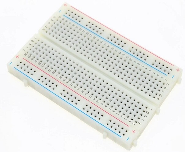

I've been planning on making an Arduino controlled car with the following parts:
Radio Module
Arduino Mega
Motor Driver
Ive run into a problem trying to figure out how to combine the two systems as the motor driver takes up the ground and 5v outputs that the radio module needs. I was looking for any routes i can take on combining the two systems.
Solder some wires together so you can connect two (or more) things to one connector. Or join the wires with a screw terminal - one wire to the Arduino pin with its other end in the screw terminal and connect two other wires to the other side of the screw terminal.
...R
Simple nRF24L01+ Tutorial
Use one of these protoboards.
Tom... :slight_smile:
