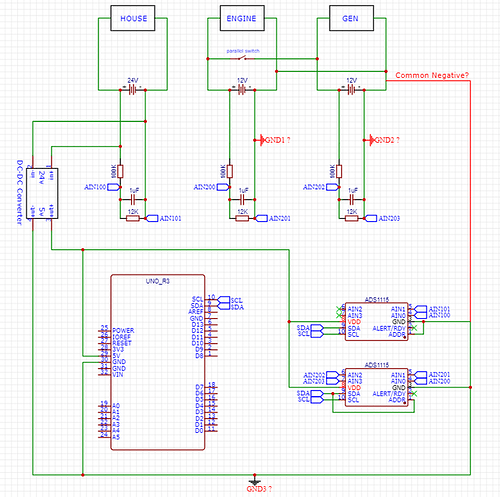

I own a yacht. It has 3 electric circuits. Engine, Generator and House. I want to read the voltages of each battery.
The Engine and Generator batterys have common negative. They have a switch, so if one of the batteries is low on charge, I can parallel the batteries and start the engine.
The House is a sparate circuit for pumps, lights and electronics. Its negative is not linked to the engine batteries. This can be charged via the generator, so I´m a bit confused regarding a common negative or ground between Generator Battery-Battery Charger-House Battery.
Below is a basic diagram of my project.
I use differential readings via voltage divider´s to get my voltages. Everything works fine on a test bench.
During questions I have previously asked, people on this forum, have quite rightly pointed out the lack of a common GND.
My question is...
How do I have a common ground? Do I have another link for each GND1,GND2,GND3? Or Common Negative link? And could I end up with a ground loop?
Any help will be massively appreciated.

Does the DC-DC converter have a common ground? How can the generator charge both 12V and 24V batteries? The problem here is that you are asking questions that only you can answer, since they amount to details about the circuit that you haven't posted (or perhaps haven't found). Have you taken an ohmmeter and just measured ground to ground?

The DC-DC has a In- and Out-
The generator has two alternators. 12v for its own battery. 240v that powers a charger that charges the 24v.
When you say measure gnd-gnd where? There is 12v neg -24v neg.
Is there away to work this without knowing the answers?
No. Your only hope of that, is that all sailboats are wired in a certain way, and some sailboat captain will read this and respond. I know full well, that the DC-DC has an In- and an Out-. I can read it on the diagram, even though it's a bit fuzzy. But because it is just a box on a sheet of paper, I can't know whether it conducts ground between the two circuits. Hence, I am asking you to go measure it, or provide documentation on the converter.
Where to measure ground? Anywhere that you have doubts. :slight_smile: But anywhere you do that, measure voltage first so you don't blow the meter.

Good. That is what a professional would do. The easiest and most interesting measurement would be between the DC-DC In- and Out-. If you have DC continuity there, then you have common ground with the "House" circuit.

My question is do I add a common gnd or a common negative from the engine start batteries to the house batteries. If I did and there is already a link would this cause a ground loop?
With few rare exceptions- All grounds connect together.
You seem to be confused about your vague DC-DC converter. If you measure the resistance from the -24V input and -5V output, you're likely to see them internally connected.
You can determine whether there ALREADY IS a ground link by using your multimeter.

The DCDC convertor 24- and 5- are common. I apologize for not confirming this before.
If, I check with a multimeter, and find the house and engine battery neg are not common. Would it be an issue to connect them in my circuit? Or is this another can of worms??
Thanks again.
Read the house battery voltage relative to the house battery ground.
Why would you want to connect the house and engine battery grounds, if they are not already connected?
You say the house battery can be recharged using the generator. Please describe how the generator is connected to the house battery for this process. Hint: there must be at least two wires, or (same thing) one wire and a common ground.
There is no second generator or charger on your drawing. Measure the voltage between the house negative and the engine +, is it +12V? With the generator running?

It does mean at least, that your schematic is wrong.

I think the OP refers to "house" as the wheelhouse of the boat.
Everyone seems to have been confused because all this mention of a generator... There's no DC generator,
there are two alternators, one at mains level that powers a battery charger for the house system, ie its
probably isolated from the engine circuit.
If there's an actual ground (ie metal superstructure), then each system is probably best connected
to this, separately, for safety reasons (because of the mains level voltages in that second alternator).
I think they are best connected purely for safety - imagine the alternator + battery charger malfunction
and put a high voltage AC on the house system w.r.t. engine circuit? That's bad news.
Use three analog signal isolator modules and all your grounding headaches go away. Also, in a marine environment grounding is even more critical and you need to be careful with running wires everywhere causing corrosion problems.
