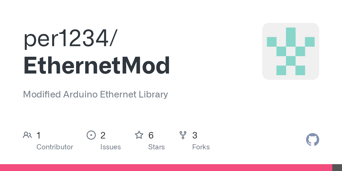

Special Ethernet library with client.remoteIP():
