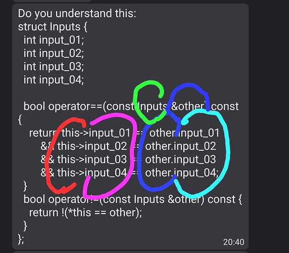

Hi Pieter,
Thanks for the struct comparison code, I definitely learned something there! Unfortunately, I didn't really understand what you have done, so I asked the friend who taught me C; for the benefit of anyone else who needs an explanation here is what he told me:
if (a == b) …
This (circled in red) – left hand operand (a). 'this' just means the current instance. Don't worry about it for now if you don't understand it.
Pink – members of instance a
other (circled in blue) – right hand operand (b). You can think of this like calling a function and passing a parameter. b is the parameter passed. other is the variable name within the function.
Cyan – members of instance b
Green – data type for right hand operand.
