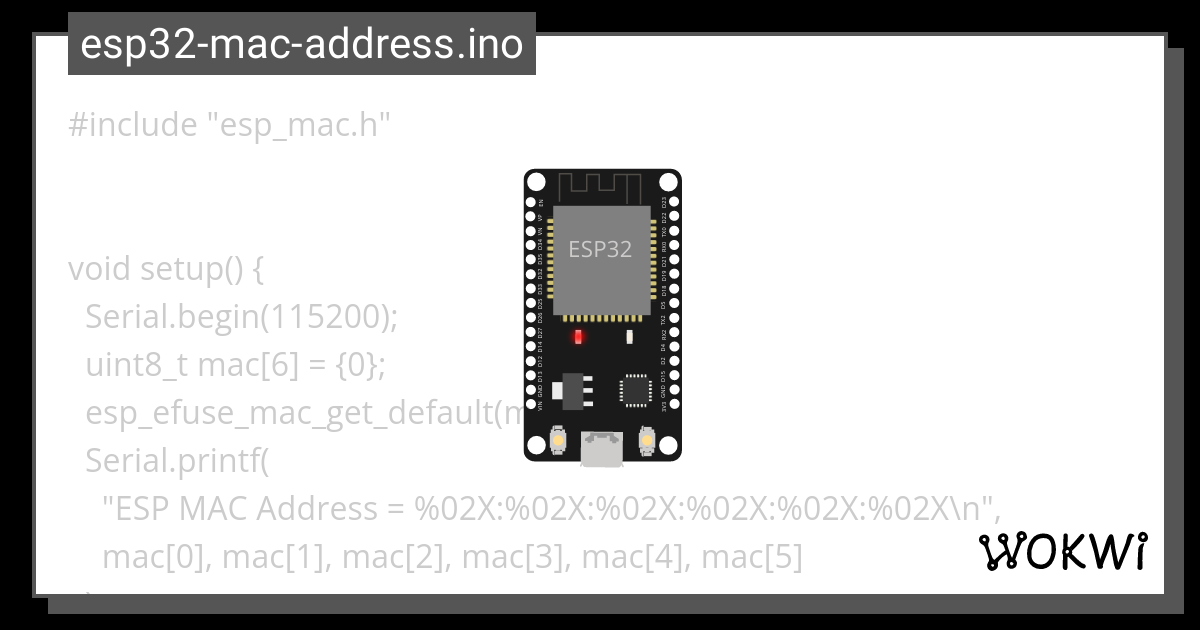

You're confusing it. The MAC address is a "hardware" code that uniquely identifies an ethernet device and you do not need to be online precisely because it is a property of the device itself.
You are using a W5500 shield, so basically you have to set MAC address via software and you can use whatever you like.
If you want to make sure you use an address that won't cause you problems, you might think about using the MAC address of the WiFi adapter already included in your ESP32 card, but it's just a refinement.
use my new EthernetESP32 library with the WebServer bundled with the esp32 platform. there is an example in the EthernetESP32 library.
@cotestatnt
Yes you have right, but i do not know how to read that unigue mac-address which is given to the esp32 from the manufacturers.
Using Espressif system API:
Using Arduino framework:
@cotestatnt
Thank you, that was helpfull.
Thank you all.

with EthernetESP32 you don't have to provide the MAC address. it is set in the library
OK.
I want that the ESP32 keeps the unique MAC that it has gotten from the manufacturers.
I do not want to set any MACs, i just wanted to read the original one.
But i will try your library.
yes it reads and uses the ESP32 MAC as recommended by Espressif
