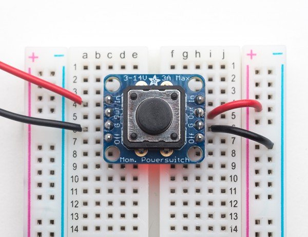

I still have most of my original starter kit components although in some cases I added to them to make them more tolerant. Many of them can be upgraded to better and can even be incorporated into the class. the push switches are a prime example where mounting on a small piece of veroboard or similar with proper board pins will make them much more robust. |500x384
Same with resistors and LED's. |500x375
That would give you class basic soldering principles. The switches cost around 99c US for 10 from Ebay and leds come in at even better prices. Resistors could also be upgraded to higher wattage ones with stronger leads.
