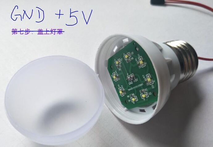

Ten LED light (image attached led.JPG)
Without knowing how much power those LED bulbs take, can't say whether your USB supply can handle this.
Do note that your Arduino pins can source no more than 20 mA, and just by counting the LEDs in that bulb I'm quite sure you'll be drawing more than that - so you need a hardware driver (transistor or MOSFET). Also not sure if it's a good idea take this power through the Arduino, maybe safer to have a power wire from your USB bypassing the Arduino.

It claims that it has 5V for the LED bulbs.
Which is true, but, the current is important. An Arduino pin can only supply 20mA.
The picture you posted in reply #3 is a totally different thing than the picture in the original post. They are not the same thing and they get driven in different ways.
This is the unit posted in reply #3
In reply #3 you have an array of 8 WS2812b LEDs. These deed to be driven with a single data pin with the appropriate libiary. These are variable colour lights and can have their brightness altered. Many of these can be driven by one single Arduino pin. Each unit like this will take up to 480mA. However being a cheap crappy product they have not soldered in the 0.1uF ceramic capacitors needed for each LED.
In the original post you have an array of white LEDs. If they are normal power then they will take 160mA but could take a lot more. In any case you will need a driver transistor or FET on the Arduino pin to connect them.

Sorry for that I placed a wrong image, what I want is the original LED light (attached image with front face).
As you said "this will take up 160mA", Is that meaning for each LED light will take up 160mA and so it is not enough supply for one Arduino pin that can only supply 20mA?
Yes each light will take a minimum of 160mA but maybe a lot more, you can't tell from the photograph. If you could tell me the numbers on the resistors we would get a better idea, they should all be the same.
So what should I do to solve this problem?
Put a transistor & resistor between each Arduino pin and the light, like this Transistors - SparkFun Learn. Note that your LED assembly already contains the resistor.

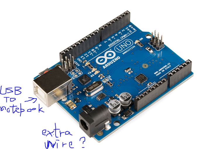

Extra wire from USB power for your lights. Not through the Arduino.
E.g. break beam sensor, pressure sensor, piezo sensor. A piezo is actually a kind of pressure sensor and may be more suitable for measuring short impact like a ball bouncing off of it.
Is the extra wire attached in this port?
(Image attached)
Thanks
No.
It goes from the positive of your extra 5V power supply to the 5V input on the lamps.
The negitave of your extra 5V power supply goes to the Arduino ground.
