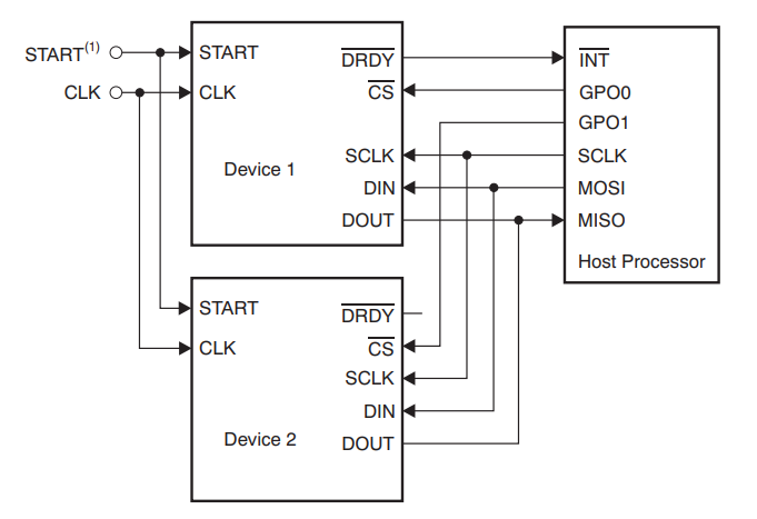

Hello Community ! I am doing a project which Includes Daisy Chaining of 2 slaves and to one master (ESP32). To achieve proper SPI Communication We need to add 2 Chip Selects for both the slaves. For that we need a clock which is common for both the slaves. Now my Question is ,
  1. Can I Configure any GPIO pin on the esp32 board so that I can use it as an Oscillator (Clock) of 8MHZ ?
  2. Both of the slaves have the pins called clk , Can I just short those two and say that they are Synchronized (Getting the same clock pulse ) ?

Since the slave chip needs an oscillator to operate and to get connected in daisy chain mode , a common (ie; one single source providing the same clk pulses for both the slaves ) clk source is needed. This is what I meant.
Additionally , please note that we are using SCLK for the Master and Slave communication and clk for synchronizing only the 2 slaves.
The SPI bus already has a clock signal (SCK), which is common to all devices.
Please post a hand drawn schematic or block diagram of the proposed connections, and use it to explain why you think you need another clock signal.
Okay I will now explain everything here :
We are Daisy Chaining 2 devices along with an esp32. The hardware Components is as follows (A power supply is used, But I haven't specified it in the Circuit Diagram here. ),
  1. Master -- ESP32
  2. Slave1 -- Device1
    3)Slave 2 -- Device 2
Now the Din , Dout , SCLK, CS1(Slave1) ,CS2 (Slave2) is the SPI Interface pins used by ESP32 and its slaves to communicate. (Which can be seen in the Block Diagram).
In order to read data simultaneously , the 2 slaves need to be in Sync with each other through a clock (which is specified as clk ) here.
Note that the SCLK is for the Communication of the Master and 2 Slaves but , clk is for the Synchronization of only the 2 slave together themselves.
Now my Simple Question is ;
Since I need an extra clk , Will I be able to Configure any GPIO pin on the esp32 board so that I can use it as an Oscillator (Clock) of 8MHZ ?
Screenshot (205)
Not possible. Only one digital signal, from one device, can be placed on MISO at a time.
Why do you think "Device 1" and "Device 2" need to be clock-synchronized?
If you want help with this project, you will have to do a much better job of explaining what it is that you are trying to do.

Thank you for your help and assistance for my Project. I now have successfully achieved the task of synchronizing 2 devices with the Internal Clock pulse and external clock pulse to each of them and they both work perfectly fine now.
