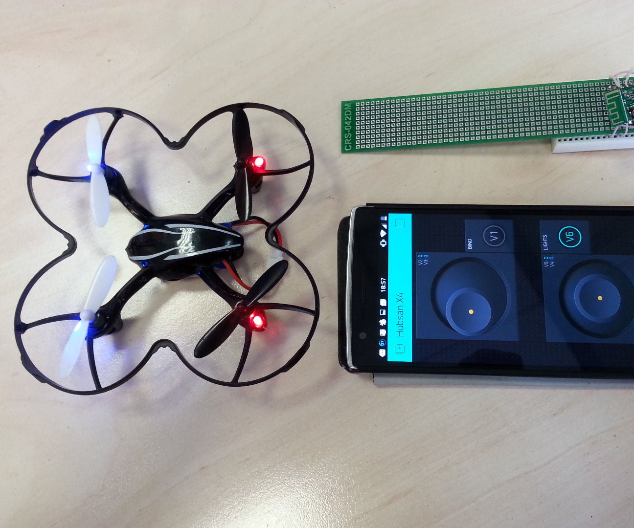

I'm working on linking my Hubsan Drone to my phone via the BLYNK app. Below is the link to the instructables project:
I plugged in my TTL cable and tried to upload the sketch with my wifi credentials etc and I'm getting the following error:
