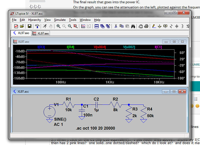

Install LTSpice IV (free).
Unzip the attached file, and load that into the program.
Run simulation (running man)
Use the probe on different points in the schematic (single- or doubleclick).
Change values.
Run again.
Leo…
P.S. R4 is the ICs input impedance (datasheet).
XL97.zip (467 Bytes)

I have done as requested. (I have wanted to have a reason to learn LTSpice)..
I have it installed, open file, ran simulation, put probe in several places... or even in one spot..change a value ran it.. change a value ran it
I saw the top portion change, to be honest I have no clue what it means, and what I should be adjusting the values to make the above....like?.. (all lines together?)
With the probe on R4, you get the frequency response at the end of your filter. The final result that goes into the power IC. On the graph, you can see the attenuation on the left, plotted against the frequencies at the bottom. You can fullscreen the black window to see it better. You see that your filter attenuates everything ~20db. That's ok, because the LM386 amplifies it again (+26db). 100hz area is bass, 1khz area is midrange, 10khz area is highs. You can see that the response, with 10n, sags above 3khz. A 6db drop is clearly audible. Leo..

2.) when I use/click the probe on R4 (it this supposed to be above it? or on the actual resistor symbol?)
I sometimes get several lines… other times I get a single (red) line displayed? Am I supposed to be lookig for/seeing all lines? (ie: the C1 line should be there as well?)
3.) What are all the V(n00X stuff?) as in V(n002) V(n004)…etc?
4.) I am trying to post a screenshot… but when I paste it into photoshop not all the lines displayed are showing up… only the V(n002) shows up on any screencap?
5.) When I click on the C1 (my C18 equivalent)… I see MANY lines above… shows my I(C1) in pink… but then has 2 pink lines? one solid…one dotted/dashed? which do I look at? and does it matter if my probe is NOT on R4?
If on R4… the I(C1) doesnt display?
I right clicked on C1, and changed it to 100n… then re-ran simulator… the pink lines didnt ‘dip’ as much? at the 3khz mark… seems to be ‘flat’ (straight) to the rest of the right…
if I use one of the suggested values of 2.2n or 4.7n… … the lines are like so:
