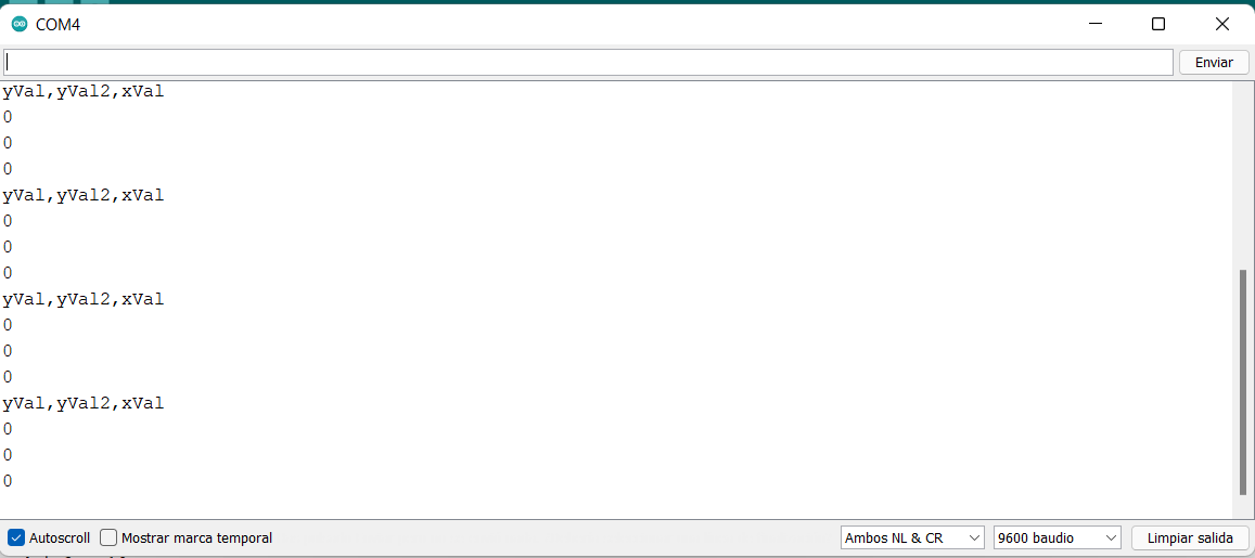

Now it is sending the data, but this happend:
Once I move any of the joysticks, the dirPins are active all the time and do not change depending on the joystick that I move.

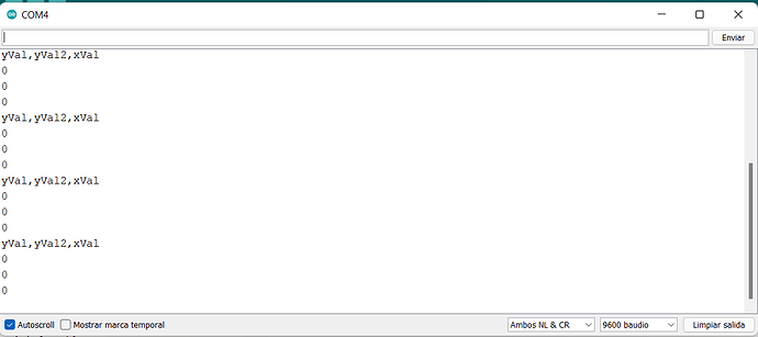

It still does not work ,and this is want I see when I go into the SerialMonitor:
Shouldn't I see the actual values from yVal, yVal2 and xVal?
Yes. I'm not convinced that the sending code is correct, but you said earlier that the message was received.
Try the sending code without the " "
MANDO.print(<yVal,yVal2,xVal>);
