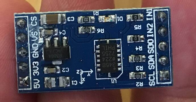

I have got the accelerometer breakout ADXL345 as shown in the attached photo and want to connect to Arduino Uno/Mega with the following codes. However, the pins in the code have diferent name to the one on the board. Does anyone know what would be my x, y and z acceleration output from board?
Can I do this using digital pins or has to be done through analog one?

That code is for an analog output sensor. The ADXL345 is interfaced using I2C or SPI. See the data sheet.
Here is a tutorial covering interfacing, sample code, calibration and link to a library for its use.

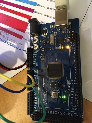

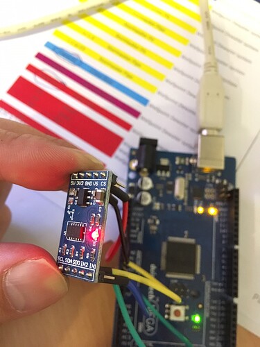

I connected them as shown in the later photos as described below.
5V from accel to 5V Arduino Mega
GND from accel to GND Arduino Mega
SCL from accel to A1 Arduino Mega
SDA from accel to A2 Arduino Mega
SD0 from accel to A3 Arduino Mega
But the problem I get fixed numbers output like this and they dont change when I move the accelerometer board:

Look at your Mega, and find the SDA and SCL pins.
It's clearly written on the board.
Hint: it's not A1 or A2 or A4 or A5.
Leo..
I saw the SDA and SCL pins and connected with correspondign pins on ADXL345. Now the SD0 from ADXL345 is not connected while I have GND and V5 also connected.

Did you read the chip's datasheet.
You must be able to if you buy a product without support.
Did you tie the CS pin to 3.3volt, to force the chip in I2C mode (page 10 of the datasheet).
Did you run an I2C scanner sketch, to see if the Arduino can talk to the chip.
Leo..
I am actually getting results when uploading "SparkFun_ADXL345_Example" from the library. The connection is
5V-->5V
GND-->GND
SDA-->SDA (D2 on WiFi board)
SCL-->SCL (D1 on WiFi board)
The output is below when I change direction of board and I also get "tap"/"double tap" events.
