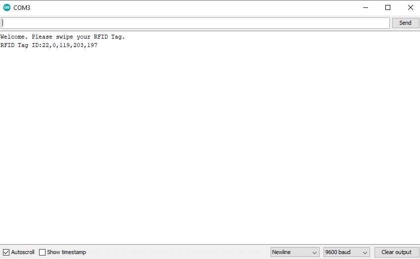

Thank you. That pointed me to the information I needed including the answer to my first question. RDY is clock frequency and flag. SHD causes the RFid reader to enter sleep mode.
Just wanted to follow up on this to share how I ended up connecting the chip to the Arduino Nano.
MOD -> D10
DEMOD-OUT -> D2
SHD -> D4
RDY -> D12

Here is the code I used. The directions in the GitHub README says to set the TIMEOUT value based on the board clock. In my case, the value of 1000 works for the Arduino Nano (16MHz). Also, make sure your RFID tag/card is the correct frequency (125KHz). Here you can see that it is working:
