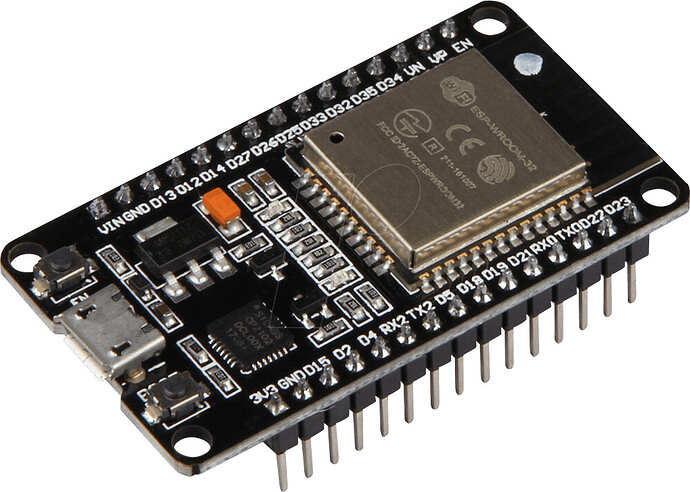

If you can afford to buy a ESP32-nodeMCU module for around 10 dollars
This ESP32-module
combines
  • microcontroller
  • WiFi
  • Bluettooth
  • RTC (real time clock)
all in one module as shown above
