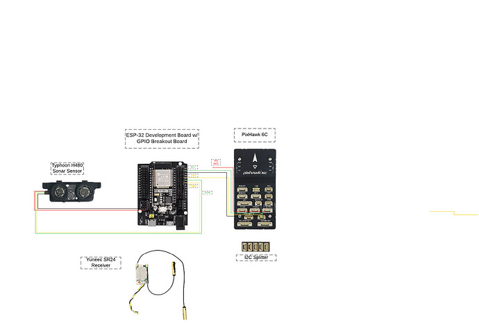

Start by posting an annotated schematic showing how you have connected the hardware items. A frizzy is not very useful, it is a wiring diagram not a schematic. We are trying to debug not build. Be sure to show all power sources, grounds, external components etc. Post links to technical information on the hardware items you have.
My assumption is that the PixMark 6C FC would be the master, since multiple I2C can be connected to it. I'll put together a diagram and upload it. The sonic sensor is working. I can see it's output on Serial output. I'm using the default SDA and SLC pins for Wire...
Here is my diagram. Does this scenario require external pull-up resistors?

The I2C bus is not a bus where you can send data and assume that it shows up on the other end. That is not how the I2C bus works.
After reading this topic once more, I think that I can conclude that it is not possible to make it work.
There is a driver on the FC side for a similar sensor that uses I2C. The initial problem is just getting the FC to detect that there is an I2C device on the bus. So, in theory this should work, but I need basically enable I2C on the ESP32.

I agree using a UART is simpler than I2C but requires adding a driver to the pixhawk firmware. The pixhawk firmware is open source so with lots of effort it should be possible to add a custom driver. That is way out of scope for this forum.
The ESP32 I2C master and slave examples work. I used two ESP32-S2 dev boards just because they were handy on my desk. I did not even use external pull up resistors because the serial console output indicated the code is working. But it probably best to use pull up resistors. There are 3 wires connected between the boards: GND, SDA, and SCL.
It should be possible to examine the pixhawk source code to find out what I2C address pixhawk expects the rangefinder to use. Then configure the ESP32 use the same address. Then find out the expected data format by studying more source code.
@customcontroller Thank you for the extra information, I still did not know if the code for the PixHawk was available and could be changed. But I assume that it does not run Arduino code.
I think that the ESP32 was originally not designed to work as a I2C Slave. It kind of works now. The newer variants, such as the ESP32-S2 can work as a I2C Slave.
@1midniterider I see that you are a skilled code writer. However, a I2C Slave with Arduino requires short code for the onRequest and onReceive handlers, depending on the used board. There is still a long way to go, and it is uncertain if it will work in the end.
Not every I2C Master can deal with every I2C Slave when the I2C Slave is a processor. The I2C bus is a "standard", but there are many differences. For example the I2C Master must be able to deal with clock pulse stretching. Sometimes it is just a timing problem that makes them incompatible.
When the I2C Master runs Arduino software and the I2C Slave runs Arduino software, then there is a bigger chance that it will work.
This is the I2C bus we are talking about and you want to use the I2C bus outside its comfort zone with a ESP32 that is not really a I2C Slave.
You are not the first one who thinks that it should be possible. I even wrote some notes about person-in-the-middle here: Arduino in Target mode · Koepel/How-to-use-the-Arduino-Wire-library Wiki · GitHub
If you can use Serial/UART, that would be much easier and it will work.
