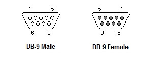

When you connect the compass to your computer and run the rion software, which DB9 pins do you connect to the compass TXD and RXD?
@jim-p
I also mentioned previously that when connecting with rion software I dont use rs232 to ttl instead I use DB9 male connector to usb (post#67) and connect it with my USB connection present in cpu.
The connections are same as they mentioned in the YouTube link in my first post.
I don't see anything in the video or post #67 that says which DB9 pin numbers were connected to RXD TXD.
Which pin number on the DB9 connector did you connect the compass TXD wire to, was it pin 2 or pin3
DB9s
@jim-p
Did you see the youtube video mentioned in first post ?
I did the exact connections as they have shown in the beginning.
DB9 pin 2(rx)-blue(tx) compass
DB9 pin 3(tx)-Pink(rx) compass
DB9 pin 5-Gnd
Then insert male DB9 to usb in cpu
And I used 5v from arduino , I didn't used rs232 for rion software.
Then the diagram I show in post #91 is correct.
