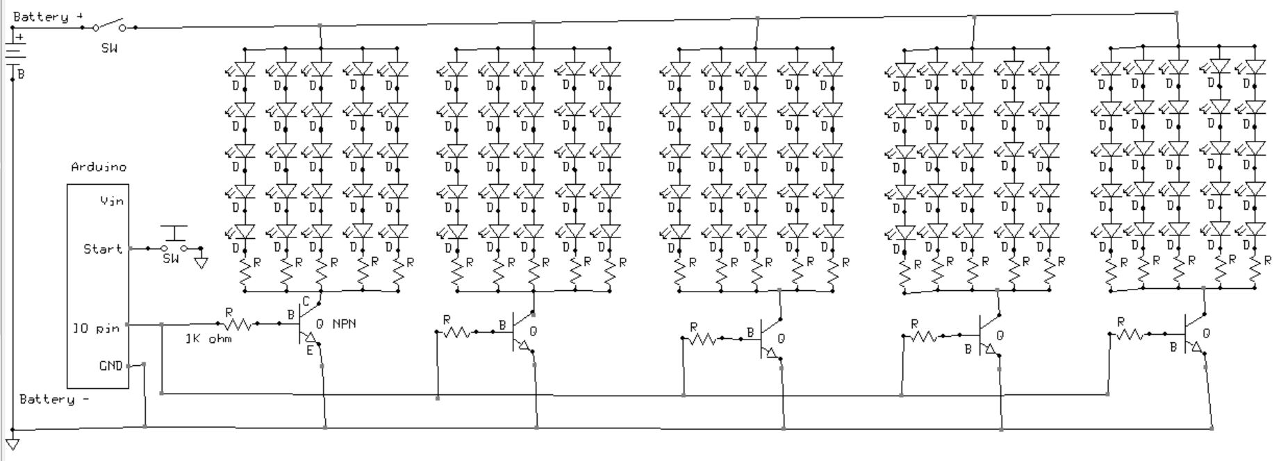

Hi, thank you so much for helping me! Right now I have 5 solder boards that are based off the circuit design I am attaching below. I want the boards to work synchronously; however, I do not know how. All of the boards can turn on and blink. However, I want it so that right when I turn on the Arduino, all 5 boards will turn on and blink at the same time as well as turn off at the same time. Below is my code and I have attached 2 images: one of the solder boards and one of my circuit design. I know each board will need its own 9V battery, however, I want to connect them so that the moment I turn on the Arduino, all of the boards work synchronously. Thank you!

Why 5 separate boards rather than just 1 ?
You need to review how to power LEDS, what you show is not correct.
Find your FET type in the drawing. Note also: signal flow is left to right; ground at bottom, +V at top.
I am using an NPN N2222. How can I like the 5 to one? I need to space out the LEDs around the cast I am making which is why I could not put it all on one board. Thank you!
You haven't fixed the MOSFET yet? Flip it left to right. Body diode and D connected to the LEDs, Source to Gnd.
With NPN, Collector will connect to LEDs, Emitter to Gnd.
Couple options:
  1. Drive all the gates, or bases, from the same Arduino pin.
  2. Use 5 Arduino pins, turn all on/off at the same time.

I did change the MOSFET to a BJT. I am using an N2222 now but have not changed my schematic sorry. I want the 5V to carry out through the different solder boards and for all the different ones to connect as well. I have tried to connect the grounds together but still, the other board won't light up. Is there a reason? Thank you!!
You can see how one signal, power, and Gnd can run out to each patch of LEDs with a transistor mounted at each patch.
Or put the transistors with Arduino, and just run power and the connection to the transistor collector to each patch.

Pin 13 can not drive more than 1 or 2 LEDs directly. Anything more needs a transistor. If you actually connected to D13, you may have damaged the Arduino pin.
I drew a 9V battery as that is what your schematic had.
Battery + (after the switch) goes to the anode of all patches in parallel.
You can power all 5 from one 9V battery. I have no idea how long it would run. I think a 1/2 hour was discussed in your other thread.
The 5V pin would not be used for anything.

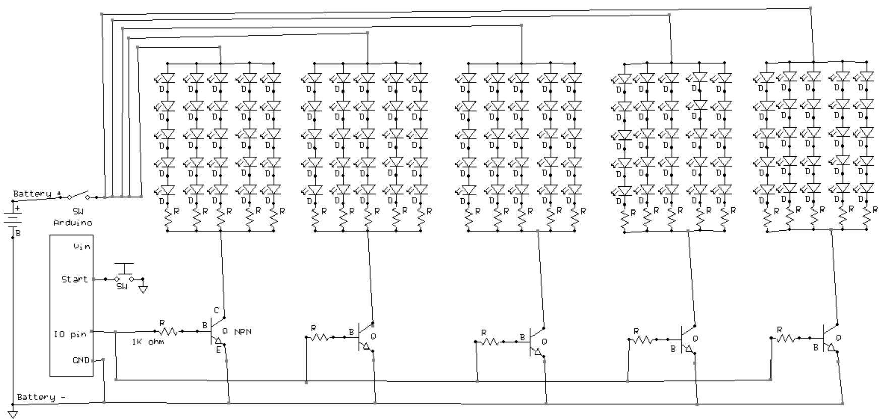

Does this make the power connection any clearer?
Yes, I am hoping for it to run for a minimum of 30 minutes. Each LED is 1.2 V (850nm infrared diode). This is a lot clearer thank you. Just to be sure, I will keep it how I have it—one BJT per solder board // circuit—I do not need to add another to connect the boards all together?

Thank you for your drawing! I ended up only using one resistor (33ohm) connected to the LED strip and collector. However, that should not matter to the rest of the circuit and the number of batteries I use. Correct? I appreciate your help!
No incorrect.
You need a resistor on each strip. This is because LEDs are none linear devices and as such will not share current evenly.
Also having such a low resistor value then the constant current effect of a resistor is diminished.

The battery negative should be connected to the BJT’s emitter and that point connected to all boards and the ground of your Arduino.
Using a BJT will drop about a volt reducing the voltage you have to light the LEDs. Where as a FET does not have a fixed voltage drop it is found by multiplying the on resistance by the total current.

Okay, so I think you're saying this now.
Every "patch" is a standalone unit, that just needs Gnd and a Control line going to the processor.
What is the resistor value in front the of the transistor?
You may be able to connect all the resistors to one output pin, you may need to use one pin to each patch.
If you do 5 digitalWrite()s to 5 pins, they will look simultaneous - your eye can't detect the microseconds of time difference from output to output.
