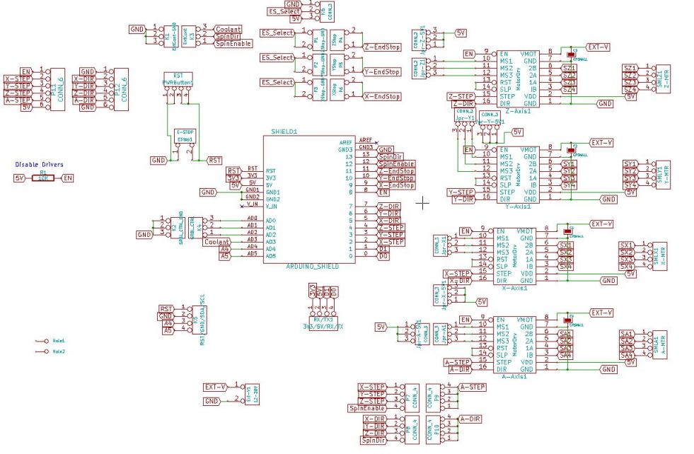

I decided to use an Arduino CNC shield as this simplifies a few things. This at least answers my power adapter question. From what I can see, people using this shield don't seem to use any step down board. They hook up the 12V input of the shield onto the Vin of the Arduino. Is that what you were advising not to do? i.e. I should go from power supply (12v) -> step down module (5V) -> Arduino?
The shield also has a 5V output, but I suspect that's just the Uno's 5V output. Provided I'm powering the Uno from an external power supply, am I ok to use that to drive 2 servos? From what I can see it should be able to provide 1A.

The shield I'm planning on using is this : Arduino CNC Shield – 100% GRBL Compatable | Protoneer.co.nz
People seem to connect a 12V power supply to it and use that to drive both the Arduino and a servo.
I'm not sure how they get away with using the 5V pin to drive the servo. As far as I can tell (and I don't have one in my hands yet) the 5V pin on the shield is just an extension of the one on the Uno.

The 19V supply is entirely fine if the CNC shield, the motor drivers on it and the steppers will handle that voltage.
vaspoul:
The shield I'm planning on using is this.
This certainly has no electronics. You would want to check the capacitor voltage ratings. I haven't checked to make sure that it does not connect "Vin" to the UNO.
vaspoul:
Well, they would need to provide a 5 V supply with sufficient current capacity to drive the servos. The on-board regulator on the UNO does not even count for such a consideration.
