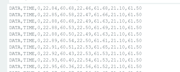

Update,
I managed to print it. Noticed I forgot Serial.begin(9600);
However this is what I have now:

And this is the data it outputs:
 ![image](https://europe1.discourse-cdn.com/arduino/original/4X/4/6/e/46edee8bc762c4f681d4ff93f0694f31ffe5f7a0.png)
I definetly do something wrong with the Wire library... Because it doesnt give anything. not even zero now!

You need to switch to the correct PCA channel before you communicate with the AHTs like you did in setup()

Ah okay, so in the loop I have to refer to the channel when I use get.event?
How would I do this? Also with
```arduino
PCA9548A(6);
sensors_event_t humidityA2, tempA2; // measure temp and humidty with AHT21B 2
  aht2.getEvent(&humidityA2, &tempA2);

> [@tiesdesign](#):
Yes just like that but put a small delay after PCA9548A(n) maybe delay (1);

and the data it returns:
 ![image](https://europe1.discourse-cdn.com/arduino/original/4X/2/6/d/26dd60ed05c7dde385e944e96fa70b952d4b7b2f.png)
very happy with it.
