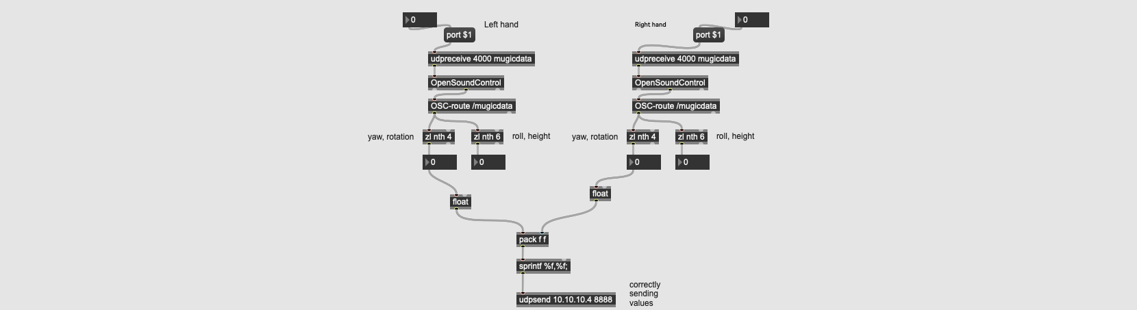

Hello,
I am trying to connect the uno wifi rev 2 using an access point (FileHub) that is connected to the laptop and MaxMSP. The code from MaxMSP is packing and sending two floats (from two mugic sensors) to the Arduino (picture of max patch attached). The uno wifi rev 2 says it is connected to the wifi but nothing is happening on the device with the LEDs. I tried trouble shooting the Arduino connection with PacketSender using the port, IP address, and type of information being sent but there was no connection detected. I am using an adafruit 24 circle led that is connected via conductive thread. Any help in keeping these three (Arduino-MaxMSP-mugic) connections robust will be appreciated!
