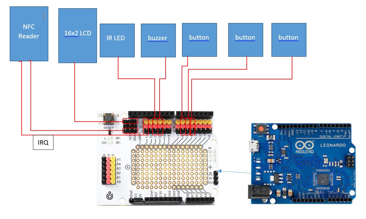

You still have not posted a wiring diagram... so "not clearly."
Sorry I am not good at drawing, not even sure which tools to use.
  1. LCD display on the I2C
  2. NFC reader on the I2C + IRQ 12 on the digital pin
  3. 3 buttons on the digital pins 4-6
  4. Buzzer on the pin 10
  5. IR LED on the pin 11
Well, my issue is, as soon as I move around big chunks of code, the issue migrates from this string and I am not sure it disappeared completely or simply migrated. Anyway, I will try, thanks for a tip.
Paper and pencil will be fine. Try to use parallel lines for wires (too many crossing lines are confusing). I am sure you will do fine... at least give it a try.
Help me please understand how this can help anybody if issue reproduces on a simulator without anything but the arduino board?
I could stare at one of my problems for hours, "knowing" I have been thorough. You could give a brief glance at my problem and see "it" without knowing, but making me realize my mind was selectively dismissing "that." You might hear it as "a second set of eyes" or on the other end "fingerprint troubleshooting" (considered the worst - when you do things because "someone else did"). It's the bystander that can see the facts without favor, when those involved can not separate it. It's not against you. We have all been to that point. My suggestion seems tangential at best. It's the Trinity: sketch, drawing, description (with datasheets for added support). You will be happy with the results. Hopefully, a good conclusion, but "results" could also mean a bad conclusion. Either way, the trinity will get you there faster.
Sure. It looks like that. All my devices are small shield and I use 3-wire flat cable to connect them to my connectivity shield that sits on top of the Arduino Leonardo.
