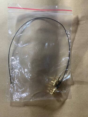

The project requires me to make a monopole antenna for the HC12 Module set to a 435.8Mhz Frequency using an UFL to SMA connector. Calculating the Quarter-Wave Antenna for 435.8 MHz gives a 17.19cm lenght.
If I am correct, I need to cut off the insulation and its braid of 17.19cm in lenght, and I need to expose the dielectric insulator and center core outside of the casing? However, the Module is deep inside of the project's casing, specifically 9.8cm deep.
My question is, do I need exactly the UFL to SMA connector cut down to 17.19cm and its center core exposed? Or what can I do is to buy a 30cm lenght UFL to SMA connector, leave 9.8cm inside, and expose 17.19cm outside? I am inexperienced in making antennas in general, I do not know much about coaxial cables.
I couldn't find any sources showcasing how it works, but here are similar projects i found
The attached image is also the UFL to SMA Connector that I bought
The radiating part is the center of the coax with NO shield around it. So make the coax as long as you need and then strip off the shield braid to make the radiating part with the given length.

A straight piece of wire soldered to the connector center pin will work fine. The length should be a little over 17 cm, but the length is not as critical as you think.
The dipole made from coaxial cable will work better (higher antenna gain), but the total length must be at least 34 cm.
Most all low cost radio modules do not use precision components in the frequency dependent matching circuits between the RF IC and the antenna.
Thus you will find, if you try it, that trimming the length of the antenna away from the theoretical 1/4 wave can improve the transmitted power output, of an individual module, by 3dBm or so.
So do not worry that the antenna length is not an exact 1\4 wave.

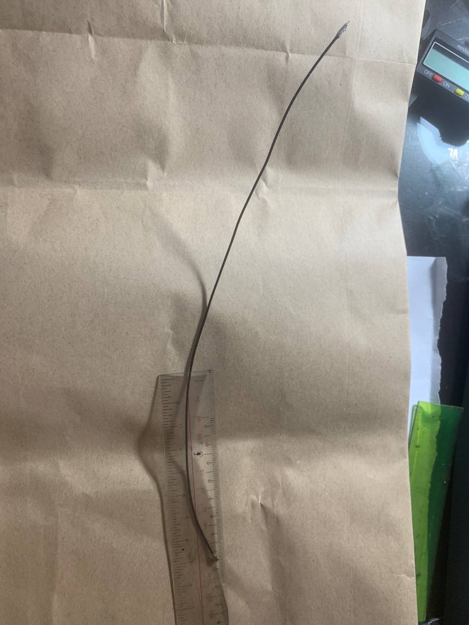

My favourite DIY aerial is a sleeve aerial.
Strip the outer plastic about 25cm and push/fold back the braid over the remaining cable. Then cut the inner part to ~17cm and the braid to~17cm.
Now you have a proper dipole of 34cm.
Finish off with 35cm of heatshrink, to keep it all in place.
Leo..

You may consider a 1/4 wave vertical like this.
Make the coax any length you want.
