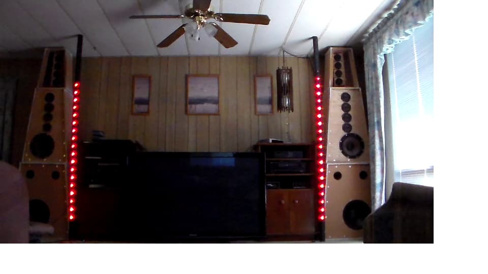

Here is a picture of my "giant VU meter" (and my giant speakers), which has 6 other random sequencing/blinking effects and there are random variations such as the meters going "down" instead of "up", etc.
Coincidently, my van has 8 strings of 7-lights each in the ceiling. I re-wired them, making a 7-channel effect like my giant VU meter. It's a regular white incandescent "rope light" but I'm "thinking about" converting to RGB LED strings... I've been thinking about it for about a year while I lazily-slowly work on a couple of other projects. If I ever get-around to it, I'll update giant VU meter to RGB at the same time.
