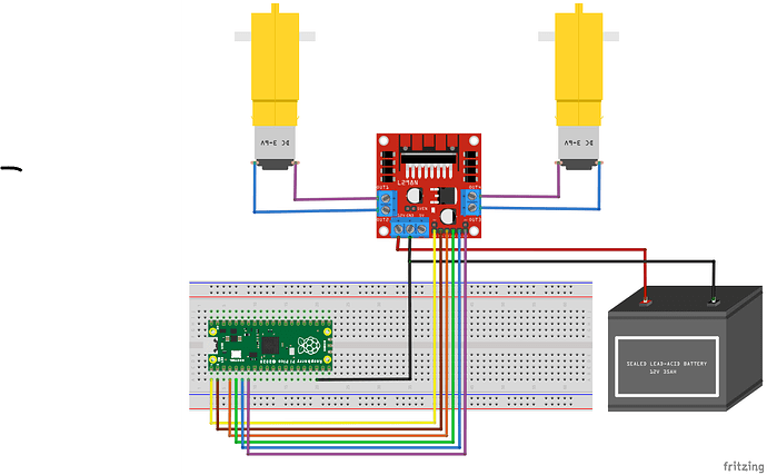

Hello,
I would like to control two motors via the MotoDriver2 and control them via a Raspberry Pi Pico W.
My problem is that the two motors never rotate at the same speed, even though the code says so.
My first thought was that my power source wasn't providing enough voltage.
I read that I can connect up to 35 volts to the MotoDriver.
I tried it with 18 volts (two 9 volt blocks) and it didn't work.
To connect everything to one power source, I connected the Raspberry to the 5V pin of the MotoDriver.
I tried it several times with different MotoDrivers and Raspberries but always either the motors didn't rotate at the same speed or there was another problem such as too much voltage on the 5 volt pin or failure when connecting the Raspberry.
Is this a known problem with this MotoDriver, is it simply not designed for this use, is there a trick and what voltage is the right one?
Thanks!

The power supply must provide not only adequate voltage but also sufficient current. If you use 2 of those small 9 volt batteries for smoke detectors expect only problems - they are not suitable for high power consumers such as motors. Of course, no two motors will run at the same speed even with the same PWM setting, simply because no two motors are exactly the same mechanically. To synchronize them you would need feedback like encoders or maybe stepper motors.
Alright. Thank you!
Gonna search for a fitting power supply and try it out!
