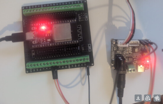

below is the connection between esp32 and the adapter
Is there a chance that the tx-rx should be not-crossed instead of crossed ? You have them the way i would, but the driver board does not seem very clear to me.
Ah ! looking through the documentation it states
For hardware devices without USB connectors, such as Raspberry Pi Zero, ESP32, Arduino, and STM32 development board, you can realize serial bus servo control and data feedback via the UART port with the hardware device, and the connection must be RX-RX, TX-TX. Note that the jumper cap of the bus servo adapter must be on the A as shown below.
So tx-tx & rx-rx so 'not-crossed'
I suppose you have the switch in the proper position.
Does it work on USB ? Oh that actually looks like quite a lot of work.
Do they really have the UART at 1Mbps ? seems pretty quick and suspicious. Can't find any information on the Baud-rate anywhere. First un-cross the lines and try again.

I tried connecting TX-TX and RX-RX (uncrossed) as follows:
  • Adapter TX → ESP32 GPIO 17 (TX)
  • Adapter RX → ESP32 GPIO 16 (RX)
  • Shared GND and powered the adapter with 12V
I also tested other configurations, including crossed connections (TX-RX) on different GPIO pairs (18 & 19), but the adapter still doesn’t work—no motor movement or data reading.
For context:
  • With direct wiring (ESP32 TX → Servo, shared GND, 12V power), I can move the motor (like with the Arduino), but cannot read data (position/load).
  • Waveshare’s tech support recommended this adapter to resolve the data-reading issue, but so far, it hasn’t worked in any configuration.
