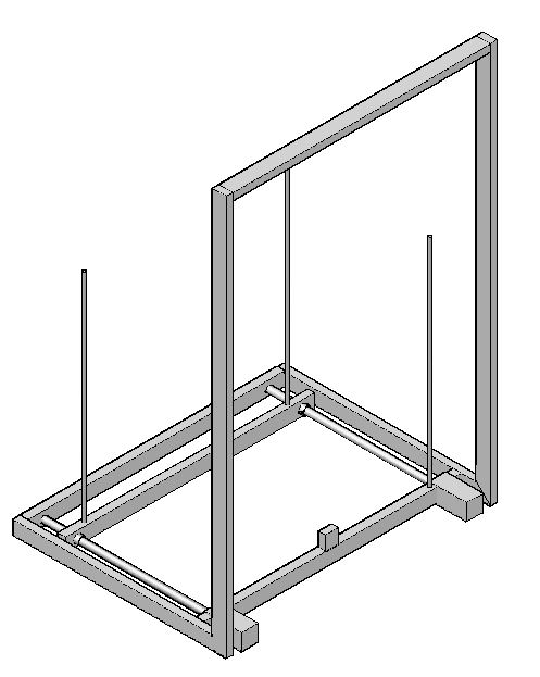

I am in the process of building a device (dock) to our modelboat in my club
The device has to opposites side, the one is mobile, now it is control by manual handle and some gear.
I will replace the gear and handle with a stepper motor that drive a line screw

I am about ready to put the dock together so I wanted to test the program
Everything is working according to plan until I change “int calculatedmove=((z1600)/80);” to “int calculatedmove=((z1600)/4);” my lead screw have a pitch of 4 mm
If I put 80 mm in, the motor is turning 20 rpm, that is fine, if I want to move to 88 mm it is turning 42 rpm back
That I don’t understand, and can’t figure it out
