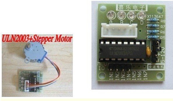

Hi all,
I am seeking to run two 5v stepper motors ( both with their individual uln2003 driver boards) of the one arduino board.
Just wondering if it is possible. It has been done with Patrick McCabes Da Vinci project ( see picture 3/4ths down the page of the wiring of two driver boards to the ardunio da Vinci )
Would anyone be able to shed some light on how he connected the power cables from the ULN2003 board to ardunio (http://i01.i.aliimg.com/img/pb/339/893/435/435893339_121.jpg) ?

Use "proper" stepper motor driver boards such as the Pololu A4988. Much simpler.
...R
Good advice. But it is possible with your board.
