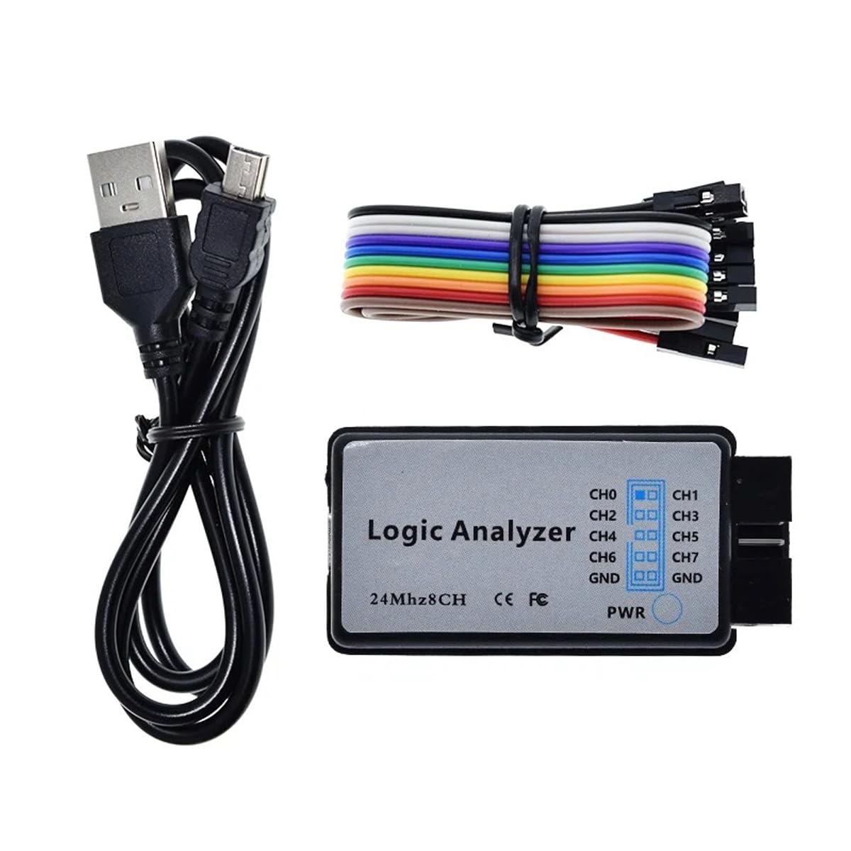

Idea: logic analysers are cheap, or a cheap good one can be had, at least. You could set up your VTX with a Betaflight FC and eavesdrop on the traffic.
