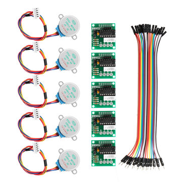

And finally this little stepper Geekcreit 5pcs 5v stepper motor with uln2003 driver board dupont cable Sale - Banggood.com-arrival notice-arrival notice
To control a regular turnstyle valve opening or closing the flow of hot water, to match set temperature.

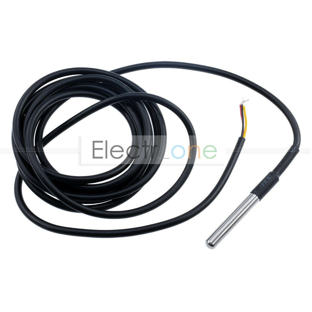

May I suggest the DS18B20 one wire temperature sensor instead of a thermistor. They are much easier to interface.
Are you sure that that stepper will have enough torque? It would be better to measure the torque required and choose a motor based on that.
The key to your success will be controlling the water flow, as some valves can require a LOT of torque. You can achieve that with a dc motor and gearbox.
It may be worth stripping the thermostat to see how it controls the water flow, as it would seem it would need less energy than a rotary valve.

I agree - dont use thermistors to measure temperature.
WEll reason for the thermistor is that it roughly fits where the old gas filled thermostat went, offcause i could just make a pipe thing with the end shut and a wire type thing to measure the same if thats easier to work with.
The original AVTQ has a diaphragm thing operating on the pressure difference at flow (to tap) and on top of that the feed from the thermostat regulating it all. So in essence the same setup. Flow as such is not really needed as a number but rather just on/off as the actual temperature of the used heating water will directly rely on how much flows true either way.
Far as a valve any can be installed, im competent with metalwork and plumbing, so any turnstyle valve i can get will work, including the simple cross top type used on faucets. (3D printer to fix interface) It doesnt have to be a ball valve that operates on 1/4 turn and are rather heavy to turn.
I am a metalworker with CNC aswell as plumbing experience, its really the finer details of electronics and programming arduino that an issue.
At any rate thanks for the input. If you could elaborate on the thermistor thing id love it, just for the sake of knowing.
Thermistors require a load resistor of accurately known value and must use an algorithm with multi!e coefficients. Those coefficients must be determined by the response curve of the thermistor. The output of the thermitor must be digitized. Resolution may not be optimal. The algorithm needs to use floating point math which on most Arduinos is slow and not precise. Each sense needs an analog input (ADC). Calibration must be performed for best accuracy. Those reasons make using thermistors more difficult. Thermistor are worth the effort if temperatures to be measured are above where other, simpler, sensors work.
The DS18B20 sensors only need a pull-up resistor (value not critical) and return the temperature in, up to, 12 bit digital form. The sensor is good up to 125C (257F). Calibration not necessary. Many sensors may be interfaced using just one digital input (one wire bus).
Right, thermistors does seem too much trouble i realise now, i was sorta thinking id just set it to whatever number made it give the temperature i want, but that does seem too much hassle for 20C give or take a couple (far as i recall original specs) at any rate itll be a number between 15 and 60C so indeed wire it is.
The DS18B20 is available in a pre-sealed tube and flex assembly which would simplify the install.
Not much more cost than a bare sensor.
Have used them a couple of times for water temp guages, far superior to anything else.
Don't forget the 4k7 pullup as already pointed out.
https://www.ebay.com.au/itm/DS18B20-DS18S20-Waterproof-Digital-Temperature-Temp-Sensor-Probe-1M-2M-2-5M/123463285963?hash=item1cbefc3ccb:g:bVIAAOSwisxcLB2b
I guess that settles the thermal part, what about the motor? lets assume itll drive the valve as intended, do i need an engine shield or to have it seperetely powered etc?

You can't power a motor from an Arduino, so you will need external power and some external circuitry to control it. That might be a motor shield, but doesn't have to be.
I was thinking id need something to run the motor. The ones i picked out was i belive made for printers, but obviusly we can still discuss gears and if need be pick another motor.
I do need a parts combo thatll run to get going thou. My suggestion was theese:
But that is really just me picking cheap and seemingly simple. If i need a shield aswell please point out one that will work.
Id like to get a few excess motors and fairly accurate ones with a little torgue, as i plan to make my next project a remote controlled spotting scope.

Also, as someone else previously mentioned you WILL NOT be providing power to the actuator from the arduino... there will be a separate CONTROL SIGNAL that the aurdino sends to the actuator. This is typically one of 2 signal types. 4-20 mA or 0-10 VDC. many of these types of actuators will also have a feedback signal of the same type to indicate the ACTUAL position of the valve.
While I expect this type of valve is above what you want to spend, here is a Stainless steel V-port with universal voltage modulating actuator and for lead free brass valve (with a standard ball... not a V-port), the price is much cheaper.
I would start with the existing Grundfoss ? motor in the existing system. since you only need to duplicate what it is doing now, but with your own logic controller and signal controller, you would have a perfectly sized motor on the system now.
