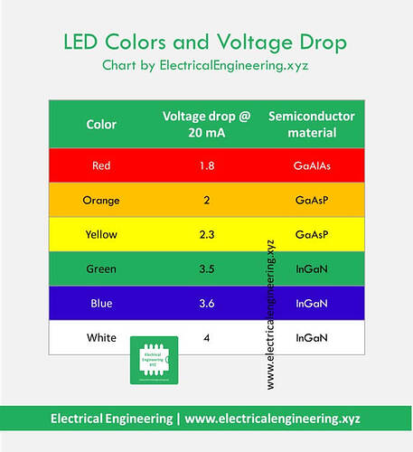

why you subtract 5 by 1.4? is it 0.7V for the voltage drop across the Opto diode and another 0.7 across the led itself?
Read the spec for the opto, 1.2 to 1.4 V LED Vdrop.
There is only a LED in the opto, no extra diode.

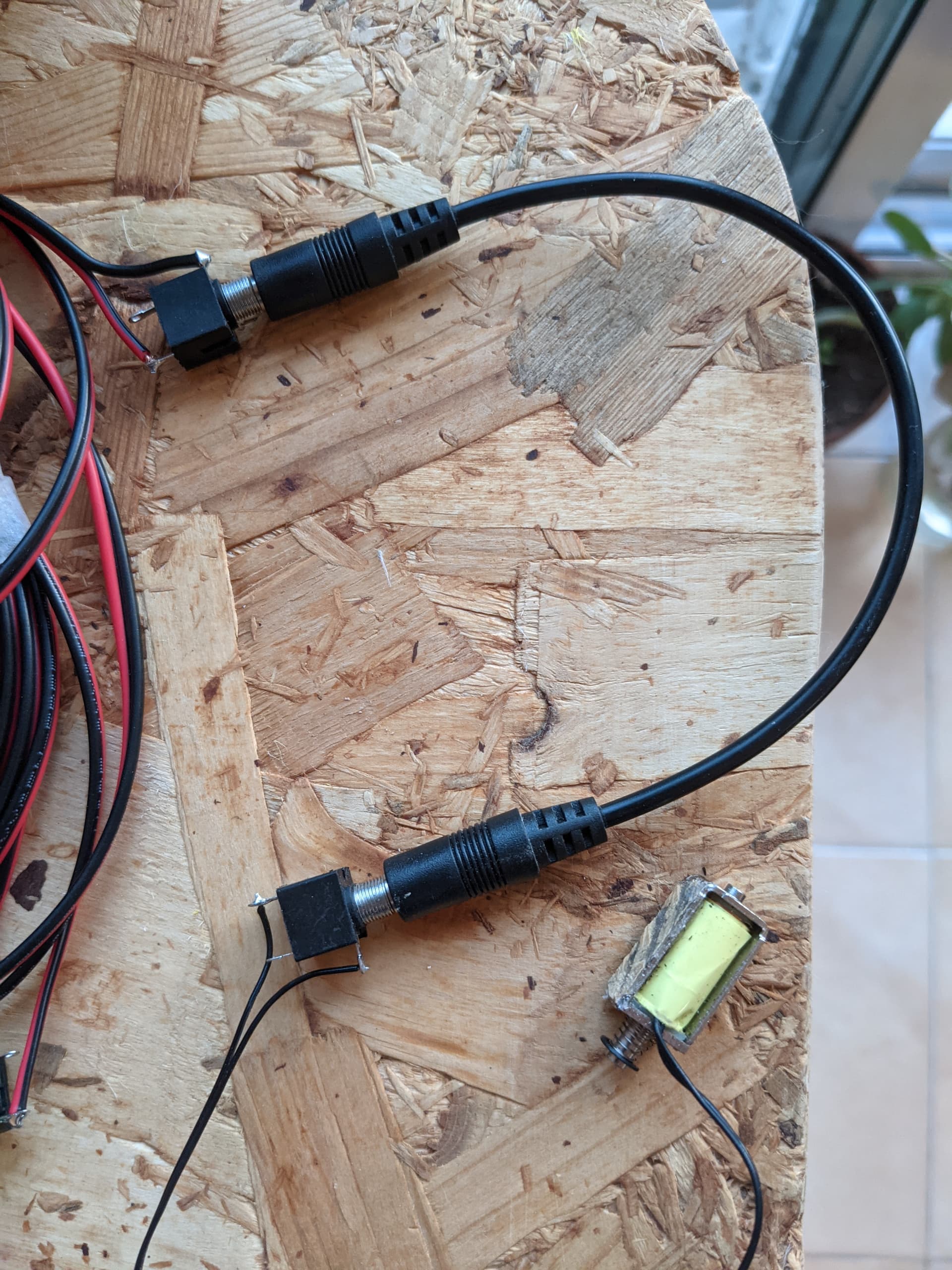

Yes they are when I'm doing it manually.
But when I've run the code with all 9 solenoids some of them were stuck and won't release until I either touch them or when they strick against an object they release without an issue.

Still some of the solenoids are stuck in their position and not turning off... :frowning:
If your solenoids fully energizes then does not retract:
  • the MOSFET is not fully turning OFF.
  • the spring isn’t strong enough.
  • there is a miss wiring.
  • the barrel of the solenoid is rough and the armature gets caught on something.
So I have made some more trouble shooting.
I could confidently say that the issue I'm facing is at mosfet driver of solenoid 1 and 5. The rest seems to work fine. What shall I look for at those drivers?
