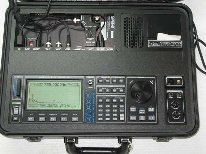

I'll try to answer what I find interesting idea. :slight_smile: Not necessarily for these small displays (16x2 or 20x4 which we use in our small/hobby projects.) but for a final product (commercially available) sometimes is more practical to have this option. This setting may be lost in time. (dust, vibrations, etc.)
For example, this product (jpeg attachment) has almost same option (contrast setting by user, analog pot anyway).
However, these types of displays are pretty outdated now.
