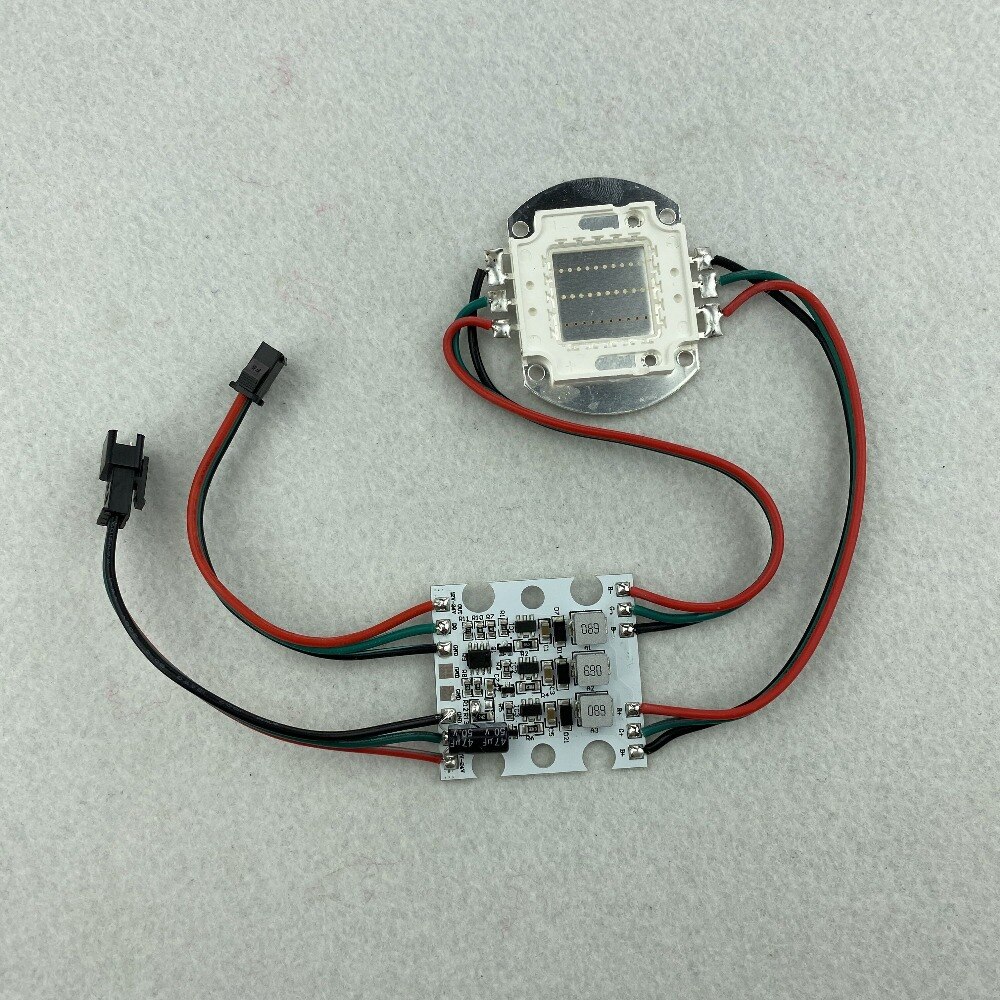

I bought a 30W pixel dot from AliExpress and it didn't come with any documentation. It stated that control would be identical to a WS2811 strip. I have no problem connecting my arduino Mega2560 to a ws2811 strip and controlling those LEDs. With the same power and data connections on the 30w pixel dot I am not getting any response from the light. It's clear that there is data being sent. Has anyone had experience working with these LEDs?

Thanks. The power lines are not connected to the Arduino. The LED requires a 36v input so I'm using an external power supply that can support 10A. The LED will go to full brightness when I disconnect it from the data line so it's getting sufficient power.

The model number is RA-WS2811-30W-RGB-36V. There is a number printed on the LED "407050020Z" but searching with it doesn't find anything....
I just realized that since I'm not using the power off the Arduino, I no longer have a common ground. Connecting the ground from the LED to the negative terminal of the external power supply fixed my issue.
