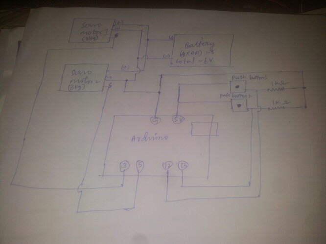

I tried it as u said
for testing i used only 2 servos. it works fine. im controlling servos with a push button. when the button is pressed servo rotates. when it is released servo comes back to original position. when i press the push button, 1 kohm resistors i used with the button gets heated up and upon the release of the button it gets cooled. if i press and hold it for a long time the resistor gets burned. what should i do to avoid heating up of the resistors. the battries im using are 4*AA (1.5V)EVEREADY batteries=6V
You must have something seriously wrong with your wiring if the resistors get hot, or noticeably change temperature at all.
Post a diagram of how you have everything connected. A photo of a clear pencil sketch will be fine.
...R
Robin2:
…R
OK --- I should have said a clear photo of a clear pencil sketch :) More seriously reduce the size of the pictures to 640x480 - it makes them easier to view.
It's a good diagram, but very hard to see. If it is really wired up like that I can't see how the resistors get hot or even warm. Are you quite sure they are 1k resistors - check them with a multimeter.
Your diagram doesn't show how the Arduino is powered. Perhaps it's from the USB connector.
Alkaline batteries probably won't provide enough current. I mentioned rechargeable NiMh cells.
You have resistors to pull the switch lines LOW and the switch pulls them HIGH. The Arduino has internal pullup resistors - pinMode(12, INPUT_PULLUP) - and then you can wire the switch to pull them LOW. That way you won't need the 1k resistors.
I would avoid using PIN13 if you can because it is connected to the Arduino onboard LED.
...R

Hi R As u guessed those were not 1k resistors. I replaced them and im powering the arduino with usb connector. It doesn't work Even if I use 4×AA rechargeable NiMH batteries. At last I used 6V Rechargeable sealed lead acid battery. Its working fine. No heating up of resistors . The battery spec is 6v and 4.5 Ah/20Hr.will this battery damage the arduino and servo.?
