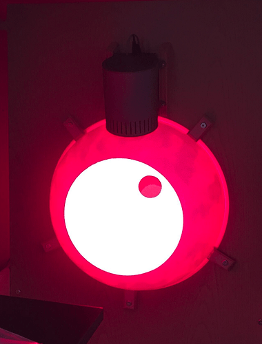

I'm building a prototype research system for studying the pupil's response to light. I have an integrating sphere, and now all I need is a light source to shine into it that ideally meets the following requirements:

Edit: Here is a picture of the integrating sphere with a high-end light engine installed. The idea is to replace that with something more affordable!
Ok you will need a hefty constant current circuit to drive and as you need to dim it with PWM you will need a dimmable constant current circuit.
Also it will get very hot in an enclosed space, so you might need some ventilation at the back and a large heat sink.
A bit of a tough assignment for a beginner.

The LED will be mounted at the top of the sphere pointing into an entry port (concealed by the light engine in the picture), and typical usage will be in 1-5 second pulses of light, or 30 second sinusoidal modulations. So with no constant usage, am I right to think that thermal management will not be such a big problem?
