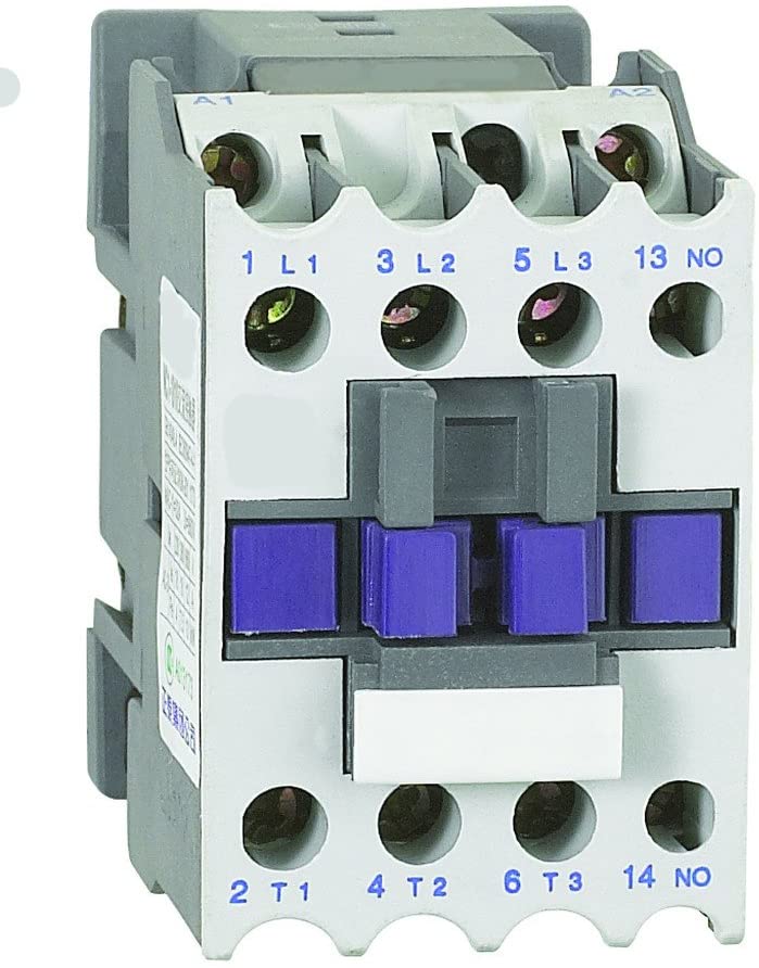

The motor is actually for a lubrication oil pump which is lubricating the conveyor.
So what I want to do is control the time the pump is running based on the conveyor speed - the motor is not running the conveyor.
TomGeorge: "Hey slow down, if you are asking questions about MOSFETs to turn 3phase 380V motors on and off."
Yes please ignore what I wrote there - I read up on this stuff later
I am actually a mechanical engineer with no experience in arduino except for some simple stuff I did in Mechatronics course at university - I have forgotten quite a lot about electronics and stuff because it was a long time ago
So, given what the intended use is, can the arduino be used reliably for what I want to do?
So if Arduino is good enough for this, then coming back to what things I need to buy, I wrote to sparkfun and this is what they suggested:
Unfortunately we don’t have the parts you would need for this, but as far as I can tell, you should only need a three phase relay large enough for your motor. Chances are a relay this size is going to be bigger than what a Pi or Arduino can drive on it’s own. You would probably need a smaller relay connected to the Arduino/Pi to drive the larger 3 phase relay. Something like our Beefcake Relay Kit should be large enough to drive a 3 phase relay.
I attach a photo of what I think I need..
