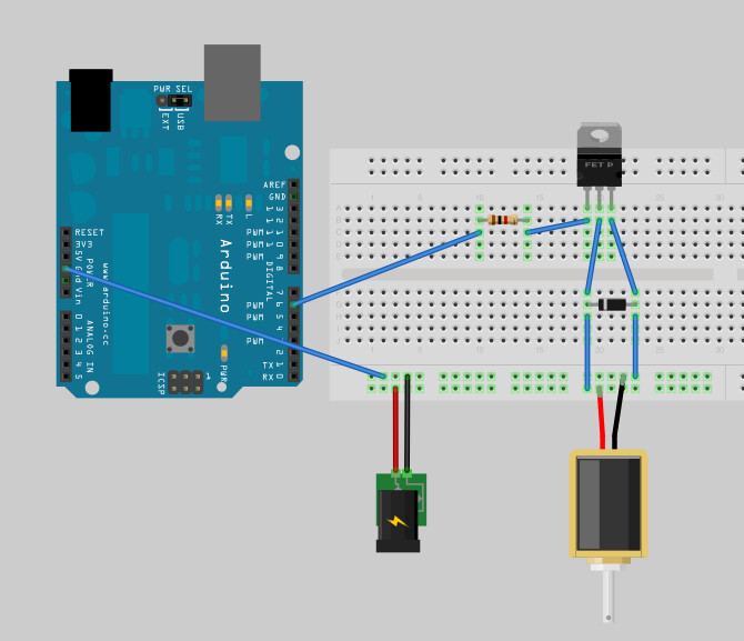

Can I control my solenoids like in this fritzing sketch?
Thanks for your help
Yes that is the basic idea but with controlling so many you will need a powerful power supply and some extra decoupling:- http://www.thebox.myzen.co.uk/Tutorial/De-coupling.html Make sure the FET you use says "Logic Level" in the data sheet, and you only need a 100R in the gate to limit peak charge current. However don't even think about using 20 solenoids on a solder less bread board.

thanks Mike. I followed this circuit: http://www.arduino.cc/playground/uploads/Learning/solenoid_driver.pdf It shows a TIP102 FET and a 1N4004 diode. this FET does not show the logic level spec. can I pick this one: http://www.sparkfun.com/products/10213 Sorry for this naive question but what is the difference between a non logic level fet and a classic one in my project?
A logic leve FET will turn on fully with a 4.5v signal applied to the gate. Most FETs take 10v to do this. Beginners are often fooled by the gate threshold value, this is not the fully on value but when the FET starts to conduct. The FET can get hot enough to melt solder and destroy itself if it is not fully on and passes a lot of current.
Yes that FET is OK, it gives the Ron value with a gate voltage of 5v in the data sheet.

Sorry, your Fritzing sketch isn’t right. It shows the solenoid permanently connected across the supply, and the MOSFET shorting the supply out when it turns on.
dc 42,
so where do I have to plug the solenoid?
Of the 4 blue wires that are connected to the diode, remove all except the bottom left one. Also disconnect the black solenoid wire from the ground rail. Then add the following connections:
  • Mosfet source terminal (the one on the right) to ground rail
  • Mosfet drain terminal (the one in the middle) to diode anode
  • Solenoid black wire to diode anode/mosfet drain
I'm assuming your mosfet pinout is G-D-S.
thanks dc42.
fritz.tiff (103 KB)
That looks correct to me.
