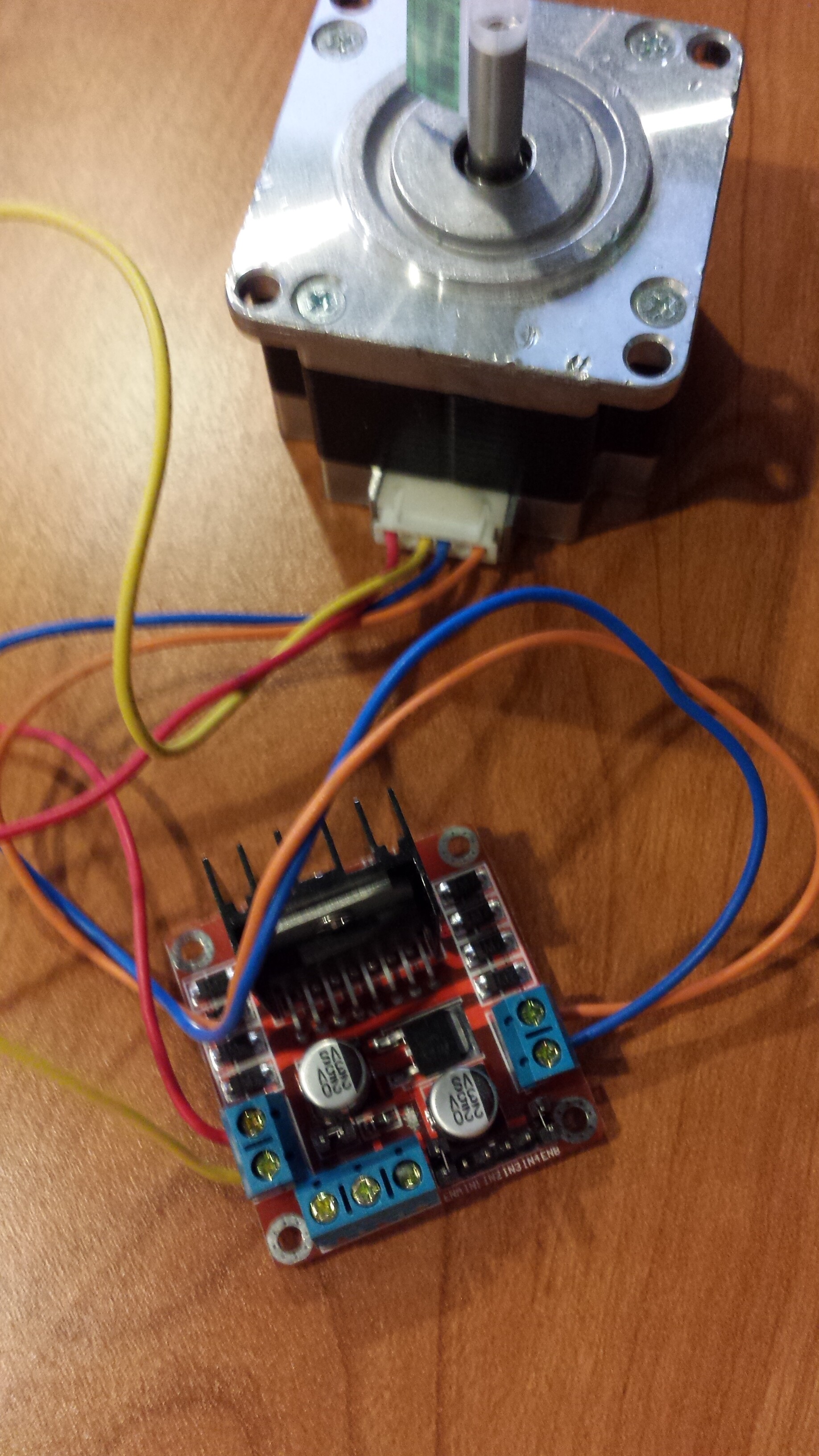

Hello!
Can someone tell me how to wire and control the DC motor with L298N DC motor controlling board?
The DC motor I am trying to control is 23KM-K246-01V
This is the code that i have so far:

OK, does anyone know if the wiring is correct?
I am attaching the specification for this motor.
Thank you!
23KM-K255U.pdf (582 KB)
red+yellow = one winding
blue+orange = other winding (bipolar mode, centre-taps unconnected),
so yes your photo shows it wired right. Now you've just got to
sequence it right :slight_smile:

Mine 298 getting really hot when I use it. It is so hot that I cannot touch it.
Can I use Toshiba ULN2803APG chip for this stepper?
How can I know what chip is good for this stepper or any other NEMA DC motor?
Thank you!
Yeah 298s usually have a heatsink as big as an elephant.
I can't say what other chips would work, sorry.
BTW, the "NEMA x" in a motor's name has nothing at all to do with the motor's electrical characteristics: it refers solely to the motor's physical size and placement of the mounting holes.

What supply voltage are you using? That datasheet says 5V 1.1A, so something like a 7.2V
supply is needed (the L298 drops 2.5V or so). Too much voltage and you'll cook the
motor and L298.

Your wiring looks fine. Also, I think the L298N controller you have should be fine with your stepper as far as simple controllers go.
Have you tried any of the Arduino examples? (File -> Examples -> Stepper)? They worked fine for me. I added to them as I needed (e.g., the ENable functionality on the driver board).
What are you using for a supply? The stepper motor can draw lots of current and a weak supply will collapse when it does (more on this later).

int MotorDriver = 12;  // Use this pin to disable motor driver at low speeds (to save power)
int led = 13;          // There is a LED on the Arduino board connected at pin 13.
int stepCount = 0;  // number of steps the motor has taken
int SpeedPin = A1;  // Analog input for speed control
int SpeedReading;
int MotorSpeed;
  pinMode(MotorDriver, OUTPUT);
  pinMode(led, OUTPUT);
  digitalWrite(MotorDriver, LOW);  // initialise Motor Driver to be off
  digitalWrite(led, LOW);          // debug, to see what MotorDriver is doing
  // read the sensor value:
  SpeedReading = analogRead(SpeedPin);
  // map it to a range from ...
  MotorSpeed = map(SpeedReading, 0, 1023, -200, 200);
  if (MotorSpeed > 10) {
    digitalWrite(MotorDriver, HIGH);  // Enable Motor Driver
    digitalWrite(led, HIGH);          // debug
    myStepper.setSpeed(MotorSpeed);
    // step 1/100 of a revolution:
    myStepper.step(stepsPerRevolution/100);
  else if (MotorSpeed < (-10)) {
    myStepper.setSpeed(-MotorSpeed);
    myStepper.step(-stepsPerRevolution/100);
  else {
 //  Turn off the Motor Driver so as not to waste power. Use pin 12 to drive Motor Controller Enable
I deleted some comments, but I think it's all there.
So I mapped the analog input to a range from -X to +X, not just 0 to +X. I had a look at Stepper.ccp to try to figure out how to reverse the motor. From memory I think the myStepper.setSpeed function requires the number passed to it to be positive (because it determined the pulse delay... and a negative delay doesn't make sense), so when MotorSpeed is negative, it must be made positive. The reversal of direction is then achieved by making the value passed to the myStepper.step function negative. Whatever the case, the above code worked.
But, as I have mentioned, I am ditching the stepper motor for a DC motor. I plan to use the same L298N to drive it. I have ordered this motor:
http://www.ebay.com.au/itm/130580506675?ssPageName=STRK:MEWNX:IT&_trksid=p3984.m1497.l2649
but I expect it will still be a couple of weeks away.
A friend of mine bought one to drive a 16mm camera mechanism. At 12V it gives the 300rpm or so. A quick check (not precise) showed it drew around about 100mA with no load, but when holding onto the shaft it rose to about 400mA (depending how hard you hold it). And it turns both ways. Should be ok I think. For $10 it's worth a shot (it's just a shame I have to wait so long to get it).
