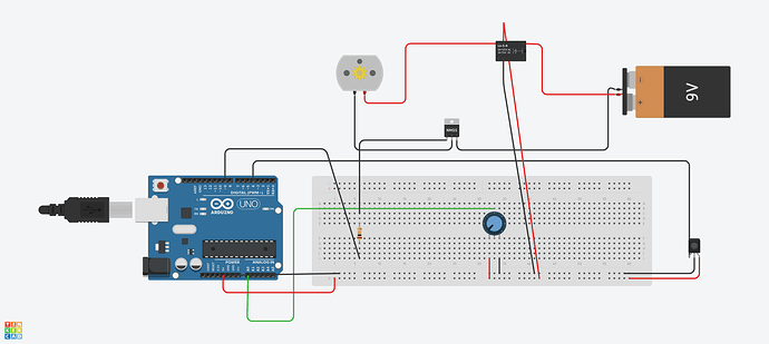

I am trying to control the speed of a DC Motor using a Potentiometer and Mosfet while at the same time using a Relay and an IR Receiver to switch the power on and off to the Motor. I attach a Picture of my circuit.Instead of the 9V Battery i am using a 9V power supply. Also not sure if i connected the relay correctly in the circuit i drawed because i couldnt find the same relay i am atually using. Relay i am using : https://www.amazon.de/-/en/dp/B07BVXT1ZK?psc=1&ref=ppx_yo2ov_dt_b_product_details. I have connected the - of the Relay to the negative of the Breadboard and the + to the positive and the signal to Pin Nr. 11 of my Arduino.

Before Pluging anything and possibly damaging my Hardware, should i change anything and would the Circuit work? P.S i am using Buz12 Mosfet 10K Potentiometer and 10K Resistor
Go back to chat GPT and ask them to give you the schematic without the relay (it is not needed) and also to put in a power source not a non existent battery. Putting it in schematic form will likely get you better help. Wiring pictures are almost useless unless you have the parts.
Power supply GND and controller GND must be connected.
Gate should have 220 ohm to gate pin and 10 kohm from gate pin to gnd.
