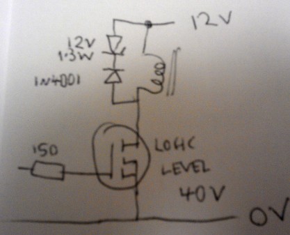

Presumably these solenoids have to turn off fast as well as turn on fast to
meet the timing requirements - this suggests modifying the normal flyback
diode protection circuit to be a flyback diode in series with a zener diode
to allow faster magnetic field collapse.

I do not know if switching on and off up to 1000 times a minute counts as fast, I doubt it, the potentiometer is to control the opening length of the electromagnet. Groundfungus has said I need a simple MOFSET switch, but could you possibly give a little more info, I really know little or nothing of electronics, the diagram posted by MarkT means absolutely nothing to me, but I am trying to learn. What type of Arduino circuit do I need.

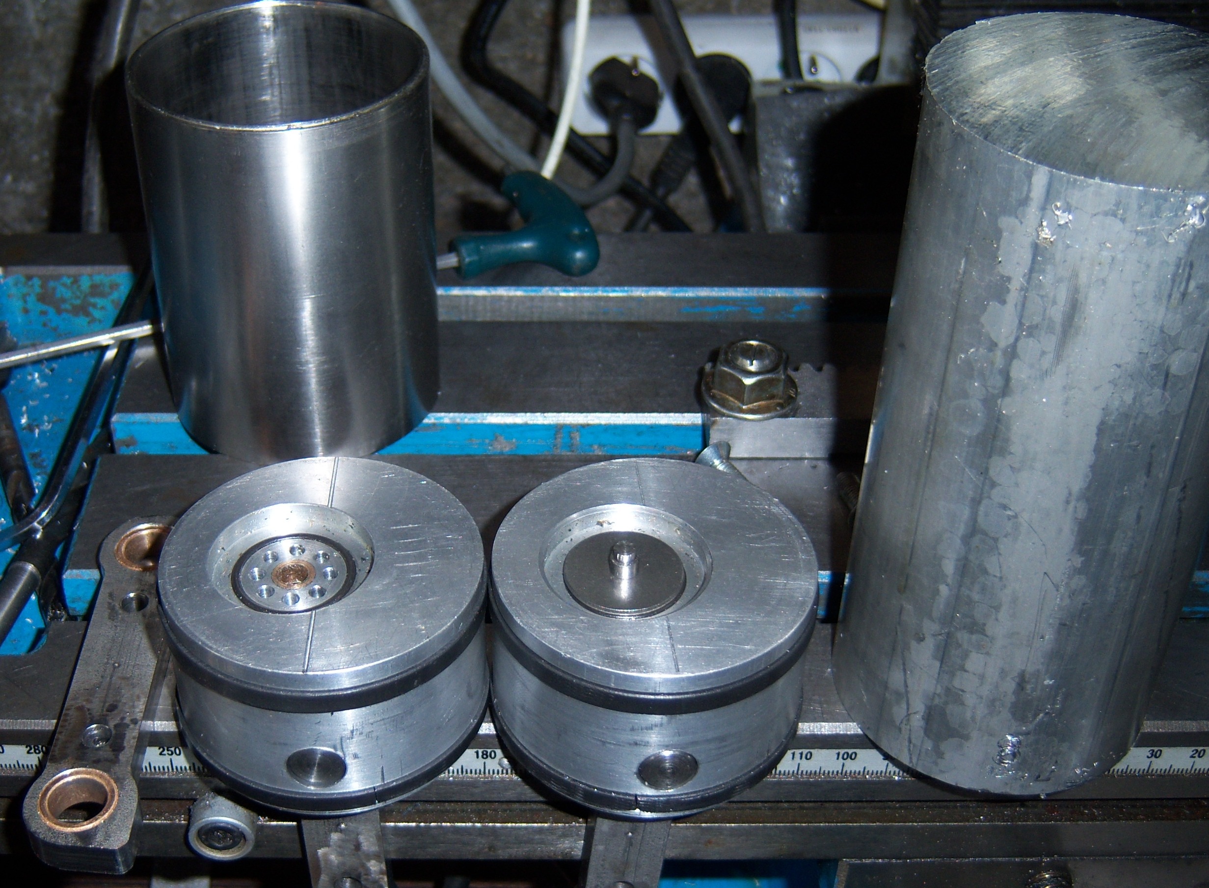

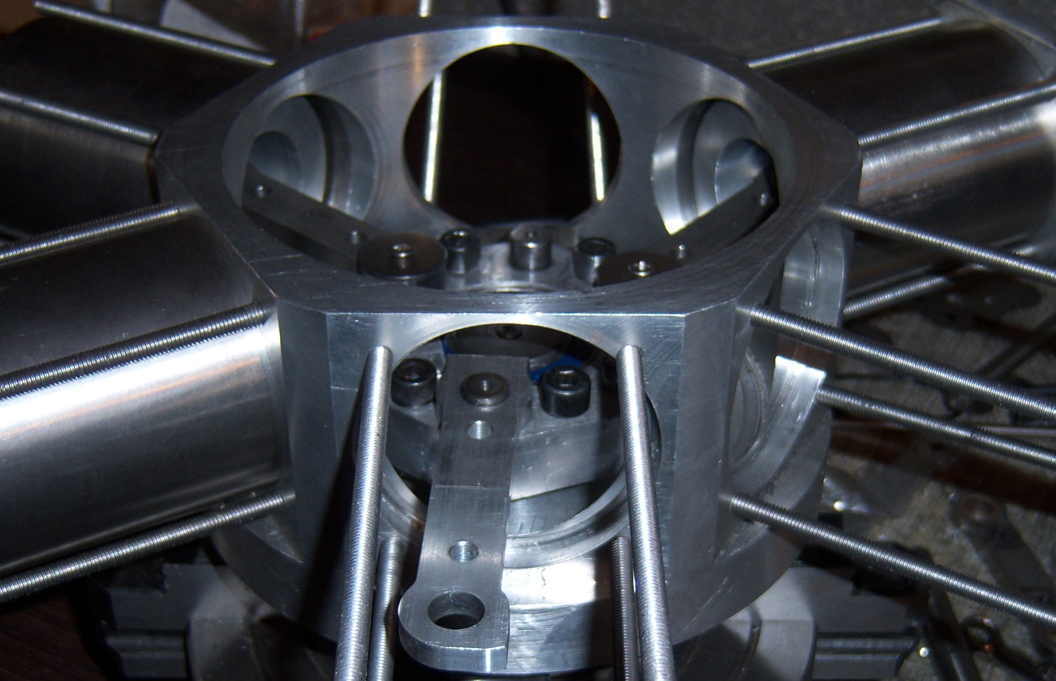

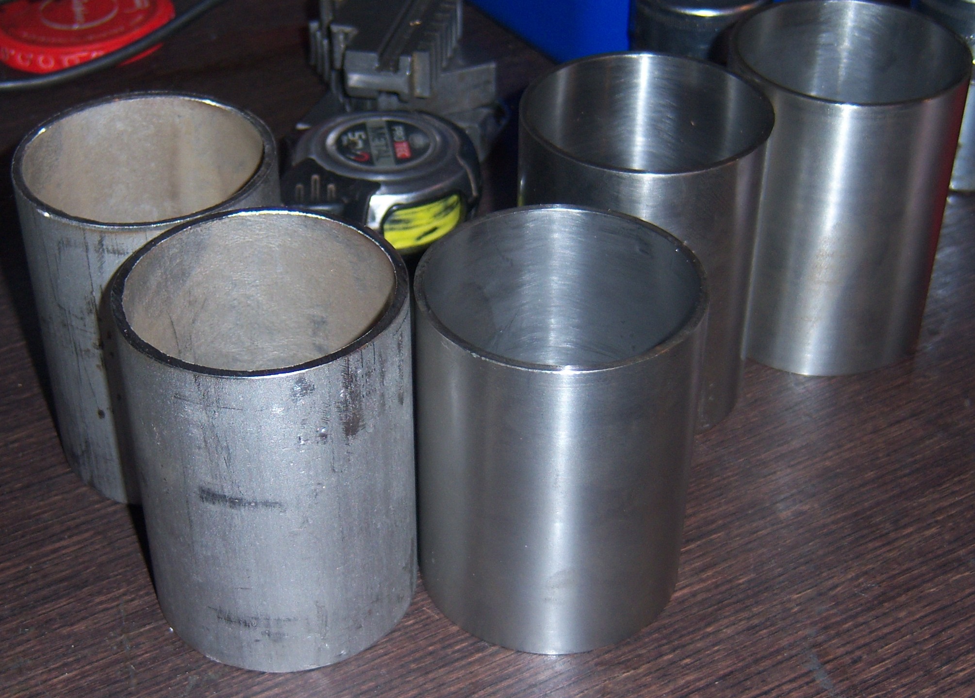

There seems to be some sort of confusion as to what I want to do. Work on the engine is quite far along, but nowhere near finished. I have finished the crankcase, pistons, connecting rods, all machined from solid, and cleaned up the cylinders from seamless stainless tube.I am about to start work on the mechanical parts of the inlet valve. I have attached some photo's one showing pistons one with the exhaust valve in situ and the other showing the holes in the piston crown, there is also a con rod showing the cam end that will open the exhaust valve in the piston, the tip of the exhaust valve will then bash open the inlet valve at TDC (apparently this method of operating is called a bash valve) which will be attached to the head, to keep the inlet valve open as the piston descends to allow steam to enter the cylinder I will use an electromagnet. I know I could use a reed switch or some other proximity device to control the electromagnet, but I want to be able to vary the length of time the magnets are energised to control the speed and power of the engine. What I want to know is what sort of Arduino circuit would be needed to read the signal from the optical shaft encoder and use it to energise and de-energise the electromagnets, varying the length of time possibly using a potentiometer. My idea is to build the engine and test it on compressed air, if it works then I will start to build a steam generator and condenser. To get to that stage I need some advice (help) to work out the electronics needed, so if there is anybody who could advise me in simple language, because I am totally clueless in this field I would greatly appreciate it. If you need any further info just ask me.
