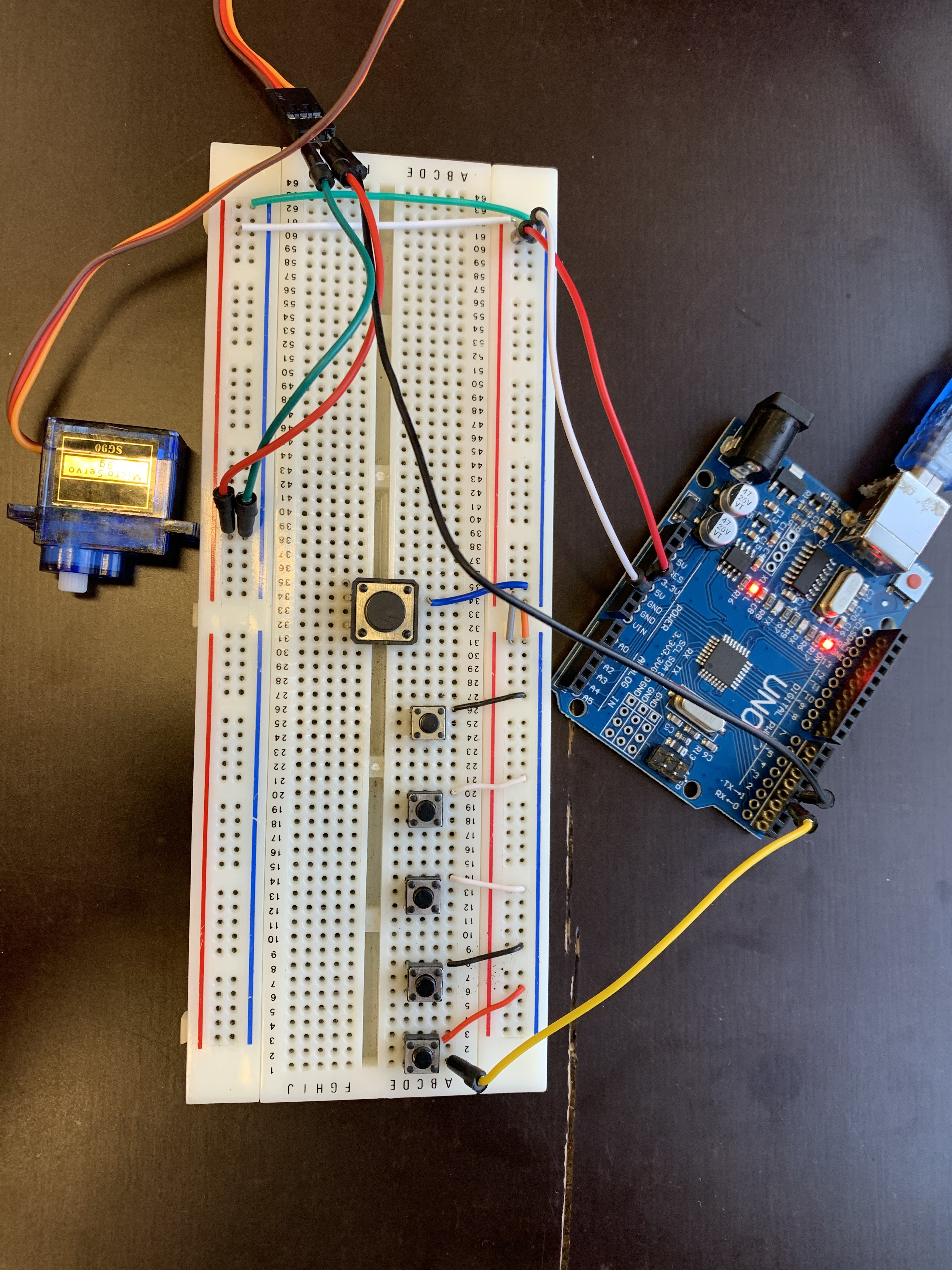

that worked well, pictured is the setup i am using, where the button is connected to ground and pin 2

Looks like you are using the 5v pin on the Arduino to power the servo(s).
If you do this your computer on the other side of the USB cable can be overloaded, possibly damaged.
You should use an external 5v (6v) power supply to power servos; this power supply should share its GND with the Arduino GND.
The external power supply must be able to supply the maximum current that all the servos will draw.

```arduino
//Forum https://forum.arduino.cc/t/controlling-individual-servos-with-individual-buttons/861547?u=larryd
//Non blocking servo control of 5 servos
//Version YYMMDD Description
// 1.00 210513 functional sketch
// 1.02 210513 made non-blocking
// 1.03 210514 added 4 more servos, total of 5

# And
You cannot power your 5 servos from the USB cable or the Arduino 5v pin.
You must use an external 5v (6v) power supply; the GND must be common with the Arduino GND.
<div class="post-metadata">
**Author:** ![lbonde23](https://avatars.discourse-cdn.com/v4/letter/l/ecb155/32.png) [@lbonde23](https://forum.arduino.cc/u/lbonde23)\
**Post date:** [May 15, 2021, 3:19am UTC](https://forum.arduino.cc/t/controlling-individual-servos-with-individual-buttons/861547/21 "2021-05-15T03:19:29Z")
</div>
thank you very much, is it okay to use a 6v power supply to power the servos or will it harm them? would i just have to use a separate 5v power supply?
