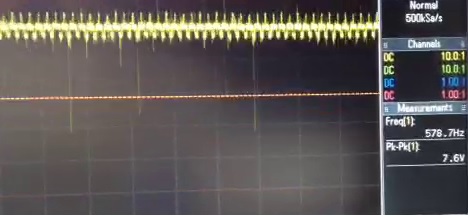

I had an oscilloscope in my lab. and i used a stop watch.
I am using Arduino Uno. the is Atmega328P, i was told that it 16Mhz clock, though default is 8MHz in the data sheet.
yeah, all my timers were supposed to be set for 16MHz. I wasn't aware i was using 8MHz somehow for timer 2.
i used the formula
F=freq clk/(2 . pre scal . (1 + OCRn))
and i put 16Mhz for the clk. How did i set it for 8Mhz?
But thanks for fixing timer2. now it giving the right delay.
I used the LED as a signal for when the PWM is on.
I am driving vibrating motors 'coin permanent-magnetic motors DC model C1026B series' with this PWM.
it will run fine if timer 2 isn't there. but once i add it. it gives me this eratic result. even now
the LED turns off at the approiate time but the vibration becomes very eratic (first 1 i send). the second 1 i sent works ok.
(all the odd 1s don't work and the even 1s work for the PWM)
does this information helps?

Here is what the oscilloscope showed
i used the formula
You used that formula to set up timer1 for the 26HZ square wave, and not timer2 for the enabled period.
I'm not sure I understand the oscilloscope traces, but from image 1 and image 5 it looks like you are showing the 26Hz square wave with some sort of ripple on the top.
I can not confirm this.
I don't have a scope, and obviously I can not debug with your motors and actual setup, but if I add an external interrupt to the sketch to monitor the timer1 output ((jumper pin D10 to pin D2) I can count 26 pulses each second during the two second enabled period. It happens every time I enter a "1" in the monitor. There is no even/ON and odd?OFF behaviour. Here's the program I am running to test your sketch.
Those square waves works fine for my requirements.
the last image shows the square wave shut down. note the mV on the side of the scope.
the images number 2 to 4 shows the wrong output, when the square waves doesn't shut down correctly, note different frequencies in the images and voltage form 7V to 10.9V. This drives my motor crazy.
You don't see the pulses after sending 1 (two seconds later), because there are non, but still some sort of output (images 2 to 4).

I can confirm the odd/even shut off behavior you see in code when I added some digitalReads of pin 10 into the test code. It is due to the fact that because of the toggle, RightPin 10 can be left either HIGH or LOW at the end of the Timer1 ISR.
ISR(TIMER1_COMPA_vect)          // timer compare interrupt service routine
  digitalWrite(RightPin, digitalRead(RightPin) ^ 1);   // toggle LED pin
To fix this, In the ISR for Timer 2, you need to set the RightPin LOW at the end of the timed sequence.

When I modify the Timer2 ISR I can see shut off every time.
