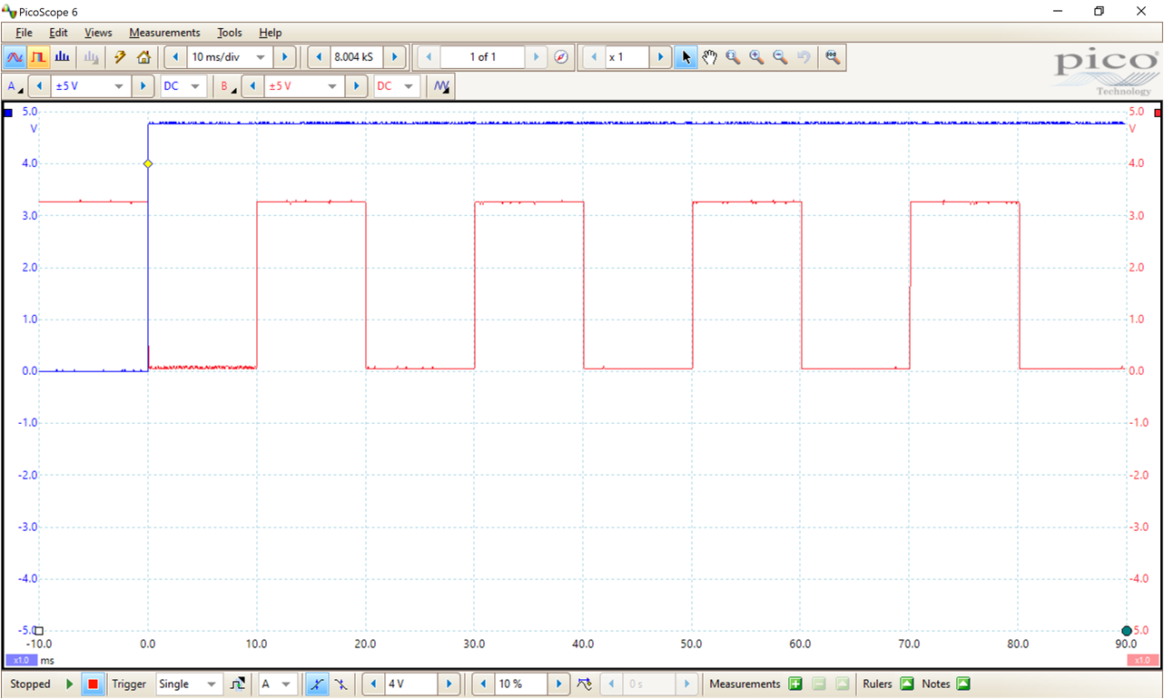

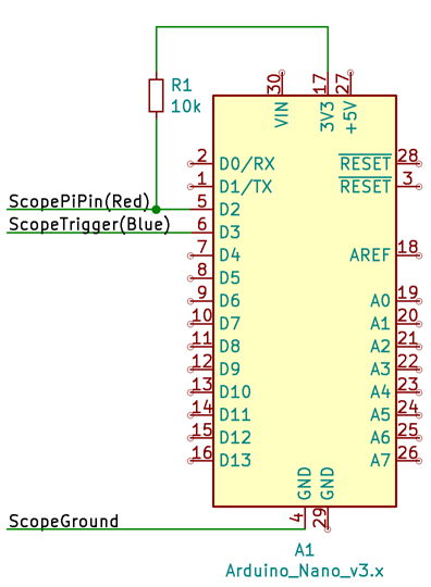

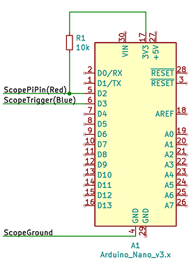

I was curious enough to try it.
I modified the code to include a signal to trigger my oscilloscope when the Nano was rebooted. The commented out lines aren't necessary, the Nano is already in that state by default after power up.

This is how I wired it:
This is the oscilloscope trace after pressing the reset button on the Nano:
[Edit: I forgot to add a conclusion, which is that it works in the way I expected it to]
