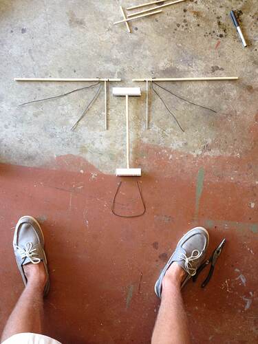

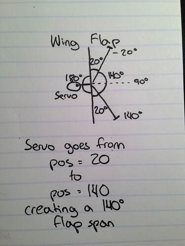

Hey all,
Currently I am working on a bird-like robot that will mimic simple bird motion (goal is just to mimic not fly...yet). Anyways i have ordered three servos one for the left wing one for the right and one for the rear(all of which are 180 degree servos). If you see my attached pictures of the skeleton i formed you can easily tell where the servos will be placed. I am fairly new to the coding side of this business and was hoping for a little help. As you can see in my code below i hoped to sweep servos as fast as they can go instead of up by +=1 degree at a time. To do this i wrote for example:
for(pos = 20; pos < 140; pos +=120) //go from 20 degrees to 140 by adding the full 120 degrees it needed to travel
wing1.write(pos);
wing2.write(pos);
My question is will this work or is += the only option. My birds wings should rotate to a peak 20 degrees and low of 140 degrees totaling at a 140 degree full flap centered within the 180 degree servo space. This leaves an extra 20 degrees of room for the servo so it should be enough and it makes no sense to have a birds wings flap from 0 to 180 straight up and down.
Take a look at the attached pics for a visual representation of what im trying to achieve it makes waaaay more sense.
Thanks for any help!

"go from 20 degrees to 140 ".
No, sorry, it doesn't.
20, 40, 60, 80, 100, 120
Your for loop will not get to 140. The "keepgoing" condition is <140, so when pos reaches 140, it will not re-enter the loop.
and
do not go together.
If you want the servo to move from where it is to another position as fast as possible, just tell it to go there. No for loop needed. No delay(), either.

I am unsure how you are mounting the l/r servos , if back to back or side by side, you will need the reverse direction for one of them, unless i'm mistaken?
If you want to create a flapping motion then you will need to control the flapping frequency. You can tell the servos to move as fast as you want, but if you're commanding them faster than they can physically move then they'll just sit there twitching.
Given your project I suspect that you don't really want 'as fast as possible' and do actually want to sweep the servos at a controlled speed and frequency, so writing incremental positions to the servo as you were doing would be the way to achieve that. If the servos are moving too slowly then you can reduce the delay between positions and increase the movement between positions to get the speed as high as you want. Note that you'll still be limited by how fast the servo can physically move.
If you don't want smooth controlled movements and really just want the servo to jump between two positions as fast as it's capable, you can do that by writing one end positin to the servo, waiting for long enough for the servo to move to that position, then writing the other end position to the servo. I suppose you could think of these as an extreme example of the previous approach, where you only use a single step per wing movement.
