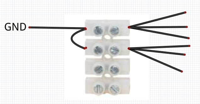

I don't want to destroy my Arduino, should i use breadboard then? Would it work..?
That's for an LDR light sensor. No laser. This sensor only draws a few mA, most of which is consumed by the onboard LEDs. Still, it's bad practice to feed it from microcontroller pins.
Use the connectors that @sterretje recommended.
If your SD card is 5V, then you can connect it and the LDR module to the Uno 5V
Anything else will need a separate powe supply
Like this, do the same for 5V
No, you can't do that.

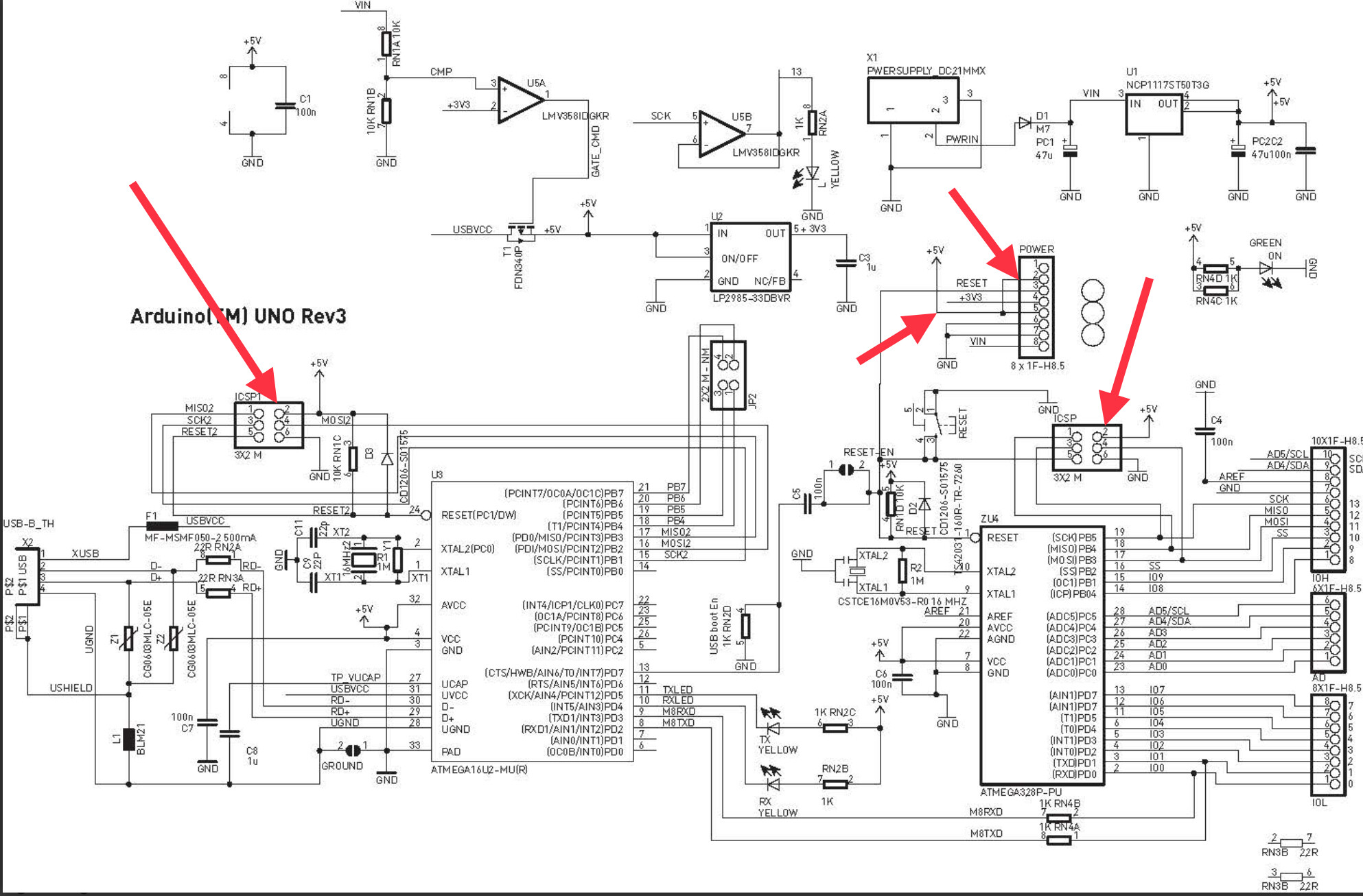

There are 3 5V pins on an Uno. One on the lower left header, and one each on pin 2 of each ICSP header. And if you need a 4th, run a jumper from the 5V pin on the header to the unused pin 1 on the same header. Me, I wouldn't do any of that; I'd just add a solderless breadboard to the mix and have all the connection points I'd ever need.
  • That’s 4 on UNO Rev 3 but who’s counting.

Ooh, good catch on the IOREF pin. I never think of that one.
I've got a Sainsmart clone that has those individual 5V and GND pins for each I/O like that RoboRED board, and I don't think I've ever had cause to use them. Seems like they ought to be useful, but it just hasn't ever worked out that way.
