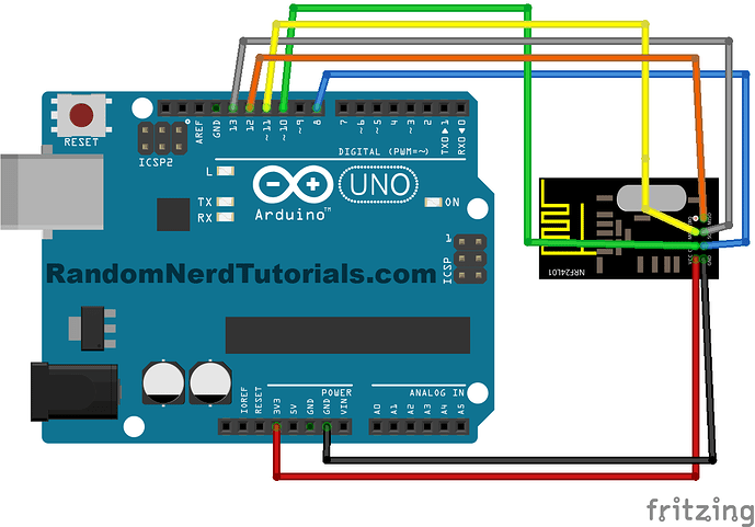

There are many things wrong with the code you posted.
Better to start with tutorials that have working examples, e.g.
