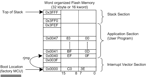

6. Execution model (Fig-2) of Assembly Program of Step-5 in Flash memory.
Figure-2:
(1) At power up, the PC (Program Counter) of ATmega328P (fresh chip and NOT of UNO Board) holds 0x0000 and fetches the instruction word C03E. It is decoded to get the offset to compute the targer address 0x0040 which is then stored into PC.

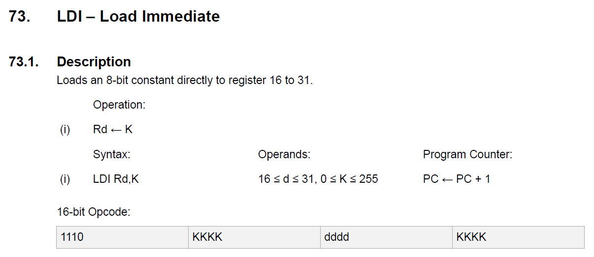

(2) At word location 0x0044 of the list file of Step-5, the instructon digits are arranged as E305 (as per instruction template) and not as E035 (8085 format: MVI A, 0x35 ===> 3E 35). Why are the digits transposed in the AVR instruction?

I don't know why. It is defined by this way. That's it. There is the instruction set in the Atmel Studio help. Each instruction have defined opcode. You can read also this:
https://ww1.microchip.com/downloads/en/DeviceDoc/AVR-InstructionSet-Manual-DS40002198.pdf
This post will give you all the details: https://stackoverflow.com/questions/61158931/convert-avr-assembly-program-to-hex
basically:
ldi r16, 0x35
ldi opcode = 1110 KKKK dddd KKKK
d = 16 - 16 = 0 ( only R16 - 31 work so 16 is an offset)
K = 0x35 = 0011 0101
opcode = 1110 0011 0000 0101 = E3 05

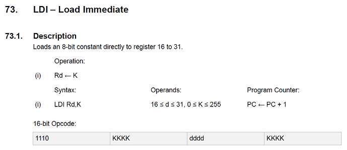

Figure-1:
In E305, the opcode and operand (data source and destination) are intermixed/embedded. If we recall 8085 for its 8-bit opcode which allows 256 possible operations.
In the ldi instruction of AVR, the operand is apparently 4-bit (1110) which gives only 16 possible operations - this is not true as AVR offers much more operations. So, the question remains as to knowing the exact opcodes bits from its template of Fig-1 above.

I means 0x0040 from: rjmp START (Fig-2 of #1) of the following
        .cseg  $0040 ; (0x0040)
START:  .........
Please explain in detail how your wording (reaching ...) should be understood.

It is the target address or jump address or destination address whose value (it is 14-bit for Atmega328P MCU though coded as 4 hex-digit) into Proogram Counter (PC). Would be glad to hear the appropriate wording. I am not sure if the PC is incremented one-by-one or 0x0040 is direcly loaded.
