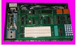

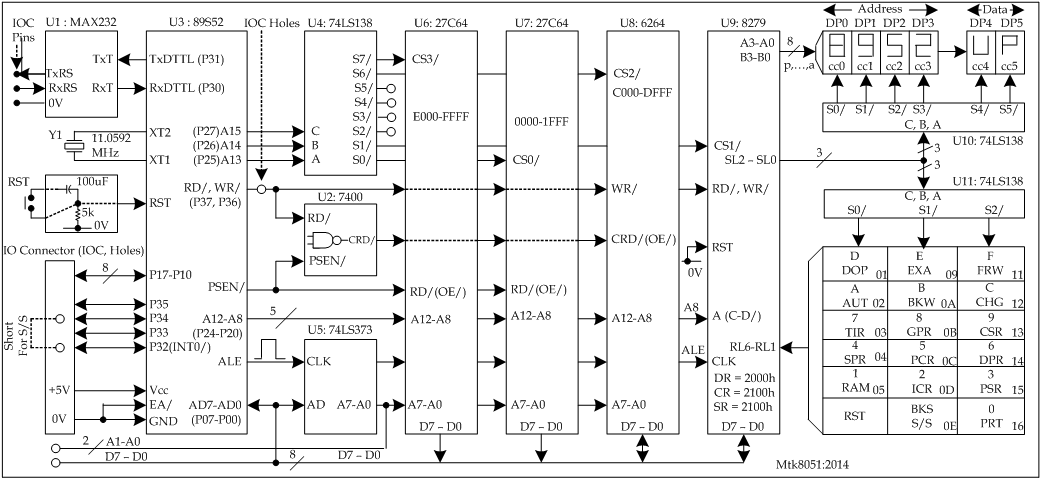

8051 MCU can be operated as von Neumann computer to fetch and execute programs from external RAM memory. It is done with the help of
JMP @A + DPTR instruction. The PC is replaced with the RAM address interactively entered from Keypad, which then enters into DPTR.
Fig-1 is an 8751 (a variant of 8051 which I have designed many yeras ago) MCU based Trainer. It can execute programs from external RAM (Fig-2).
Figure-1:
Corrected Version; (U2 is a NAND gate);
Figure-2:
External memory use can be different from internal memory use and architecture.
Well, sure, if you've "OR"ed PSEN and RD, and have thus decoded the external RAM as both "program" and "data" memory. (which I guess is pretty common, especially in these days of easy-to-use large RAM chips. But not really "intended configuration.")
